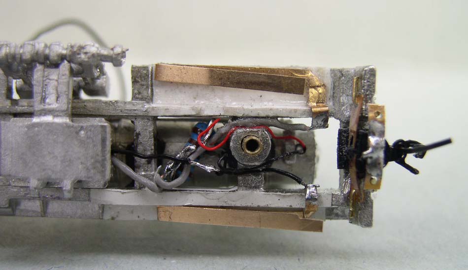

OK, well, I photographed this before I painted everything, it's all grimy black now, but this is how I jammed the dropping resistor for the LED in there.  You can see the 'heavy work' I did in bringing in the headlight wires, the 'fingers' centering the MT 901 Z coupler, the .020 wires pinning the retainer plate, coupler fingers, too.   And the two wires to the left are in a hole that is diagonally drilled through the boiler and comes out in the backhead.  The wiring connections to the cab, the rear headlight, and the drive unit are all tucked in the cab.
I did the back headlight on the cab roof exactly the same way I did the Nn3 one, the resistor is glued to the cab roof inside all the way to the front.  Cab is still very much open.
If you look closely at the photo you'll see why it was so important to cover everything metal in .005 styrene.  I also make a habit of not using shrink tubing unless I have to, I'd rather solder connections and paint them and insulate the area.  Shrink gun heat here would have damaged who-knows-what.
Oh, and Peteski, all this was done before your resistor posting.   Will definitely try that for the next one.  Finding space for those stock resistors has been an issue with my headlights.

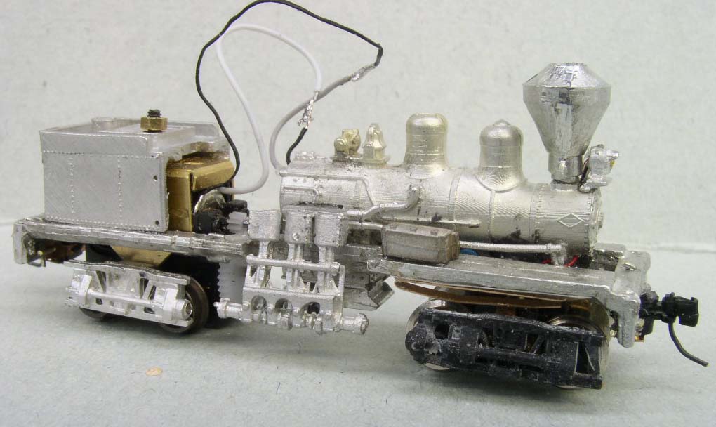

I'll put this in the thread so it doesn't get lost (I've posted this elsewhere), this shows the front pickups as installed, and was before I did the headlight wiring.  This was testing the front truck pickup with all the weight on it, tweaking the contacts for weight distribution.  When those were painted black they pretty much disappear.
Link: http://www.randgust.com/ShowShay4009.jpg
As far as the project, last night was putting on the .010 wire boiler handrails.   Well, that was painful.  Stanchions had to be hand-fabricated from wire, and drilled in the pewter boiler.   I did real well until the last one, finally snapped off a lubricated drill bit, lucky it was only one, but pewter is so miserable to drill tiny holes in.  And I probably lost three stanchions on the floor or workbench.  But it's done.
Well, one more 'acid test' before paint, ran it all over my logging module looking for glitches, hangups, and curve issues.  See how it handles all my Trix curved turnouts and 7 1/2" interior curves.  Those Trix R1+R2 curved switches have a LONG insulated frog, and the primary reason to either make the front truck electrically hot on these or don't bother at all.   The only thing that showed up was that this locomotive has ZERO ground clearance under the drive unit, it will hang up on anything even .010 over the surface of the rails.  But other than that, wow, what a champ.  No issues.  On to paint!

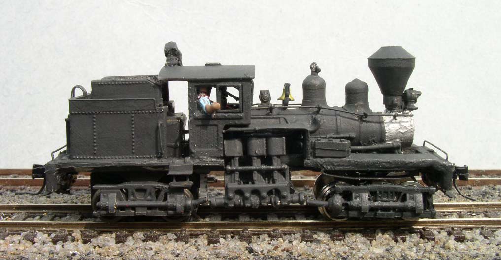

It's getting close anyway.
So you can see a couple mods in this shots, other than painting.   I got the bell replaced.   The oil bunker was ground down, and made into a coal load.  Something removable has to hide that mounting nut, that's my story and I'm sticking to it.
The highly fragile steps are on, handrails, and grabs.  Fake driveshafts.  Crew in the cab.   I'm please with the degree of invisibility on all the additional wiring and pickups in there.
Still have to add the window glass, builders plate, number plate, maybe "W&D 6" decals,  one more round of touchup painting.  And probably the wood ramp on the RH side going over the toolbox as it was 'left to die' in Endeavor.
But overall, pretty happy, and the performance is just exceptional.  I have  a couple Atlas Shays, and while they are great, I always have my heart in my throat watching everything spin and hopefully not throw off universals or a driveshaft.  And they are stiff; they don't like any track warp of any kind, will stall.   This has better low speed, surprisingly good adhesion and tractive effort, and with the 'hot' front truck, it doesn't stall at all, it's a flexible little monster now.  That front truck pickup and the couplers are the two design flaws that if you beat them, it's a winner.
Link:  http://www.randgust.com/ShowShay4011.jpg
