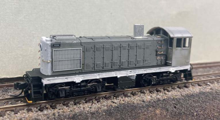

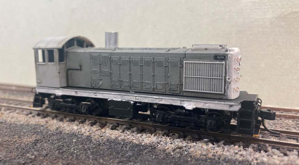

A couple years ago I got in an Atlas S-2 to do a custom paint and detail project on.
OK, I'm a skeptic on about everything, but holy smokes, that was an impressive locomotive for performance and appearance.  When I sent it back to the customer I made a note that it was as good a switcher as I'd ever seen.
When I took my west coast trip with my parents in 1972, there were FM's and Alcos everywhere, and at that time, Winslow was still a real division class yard.  But it was a surprise to me to find out that the assigned switcher at the time was a pair of S-2's, at least according to Qstation.  Huh!  Another discovery, and one unit was 2377.
I've been pretty happy with my EMD SW8's for performance, and I'd changed the mechanism out under my LifeLike shell with a Kato NW2.  Very happy with it as a yard switcher.  But apparently, the wrong one.
With me, performance always wins.   My SW8 on a Kato chassis was an impressive performer, with a weight of 51.2 grams and tractive effort of 11 grams, for 21.2% adhesion.  The original Life-Like chassis had a nasty habit of having the wheels corrode up and stall, high maintenance, so the Kato chassis has been my go-to switcher for years.
Finally broke down and got an Atlas S-2, and really got into it.   Wow.   Great performance, but on exam, wow, there's still a lot of air in there.  The non-sound version cab was entirely empty, air space over the motor, air space in the nose....  Hmmm.  Let's fill that up with weight and see how it goes, it's already heavy with a metal shell.
So with more lead added everyplace it will fit, this was really impressive....now it's up to 65.7 grams and tractive effort of 13.5 grams, 20.5% adhesion, so not only is it the right locomotive, it's outperforming anything else and can drag a yard cut nothing else can touch. Solid pickup, great low speed, silent.   So now, this is a project.
Paint was stripped, details being changed, and because I'll do wire handrails, everything was taken off or ground off.   White paint is just primer under what will be yellow.  Grabs already moved over to wire.   Stack changed to that signature oddball ATSF stack made from aluminum, reinforced into the body with steel pins.
Link:  http://www.randgust.com/Alco237701.jpg
Link:  http://www.randgust.com/Alco237702.jpg
Here's the drive, note the lead over top of the motor, and the black light barrier casting is loaded as well
Link:  http://www.randgust.com/Alco237703.jpg
So here we go, I'm sure I'll get a few 'what tha heck has he done....'  but hang in there, this one will get the full treatment.
