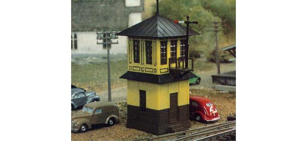

I'm debating for a first step using this double:
...to do a nice double-track fill with a PRR interlocking tower:
...which is a model of an actual PRR tower at Warren, PA, and works until I can scratchbuild a more Middle-Division-feeling tower. With two set sof crossovers from Kato:
...with the concrete ties painted like wood. And lastly, I would need some LED position light signals. Sadly I missed the nice ones NJI made. So that's an enigma for now.
So that's what I'm thinking for a first step.
