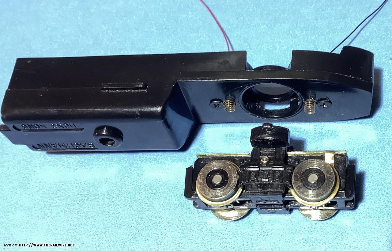

While waiting for prewired LED’s to be delivered, I examined the trailing cab to see if/how I might add a single, “always on” red LED to the rear nose cone as an end-of-train marker.
Here’s the trailing truck assembly - there’s a substantial amount of room in that shell!
Once again, I’m leaning towards somehow using one of those little ESU wheel wipers to get track power into the cab:
After a bit of trial and error, I think I’m going to try the following arrangement.  It’s simply two pieces of thin brass sheet to which I’ve soldered the copper wheel wipers (salvaged from that ESU gizmo).  These will be epoxied to either side of a thin styrene insulating separator … a “sandwich” of sorts.  The wheel wipers will be bent 90 degrees to squeeze behind the rear wheel faces, and the brass pads will then serve as the main conductor surfaces:
Those little springs in the single axle power pickup bogie seem to be working quite well, so I’ll try a similar approach here.  I’ll drill two vertical holes through the top of the bogie chassis, centred over each of the brass pads.  Then I’ll drop a spring, straight up & down, through each hole.  One end of each spring will rub on a brass pad, and the other end will be soldered to a length of decoder wire.  At least, that’s the theory … what will actually happen in reality is anybody’s guess!

Here’s how the “brass sandwich” conductor pads turned out, held in place on top of the truck with double-sided tape:
Also shown are the spring-based commutators, and if one looks closely at either side of the truck-retaining tower, two small pilot holes are visible in the floor of the chassis.  After being drilled out, these are where the springs will pass through.

Completed installation of the ‘commutator’ springs, as part of the ‘always-on’ rear red marker light sub project.
I first needed to provide two small blocks of styrene inside the bogie shell, into which I could drill two holes (from the bottom-side-up), to serve as retaining “wells” for each spring.  The styrene ‘bridge’ spanning each block acts as a backing plate for the springs, with much smaller holes through which the wires have been inserted:
And here’s a pic of the bottom side - two small black screws are holding the styrene blocks in place, and the commutator springs have been nestled into their retaining wells:
I snapped the two-axle bogie back into the chassis, placed the assembly on a piece of track, and confirmed continuity between the track and each of the wire ends.
