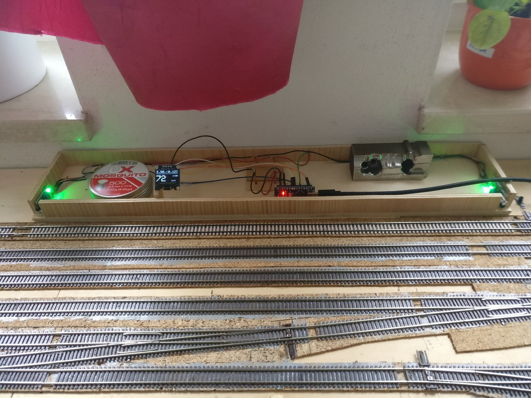

I'm working with this one:
I take the CV 5 and CV6, that works for me.
mid speed 72 km/h and full speed 144 km/h for all lokos what I have.
Distance between the sensors 50cm.
