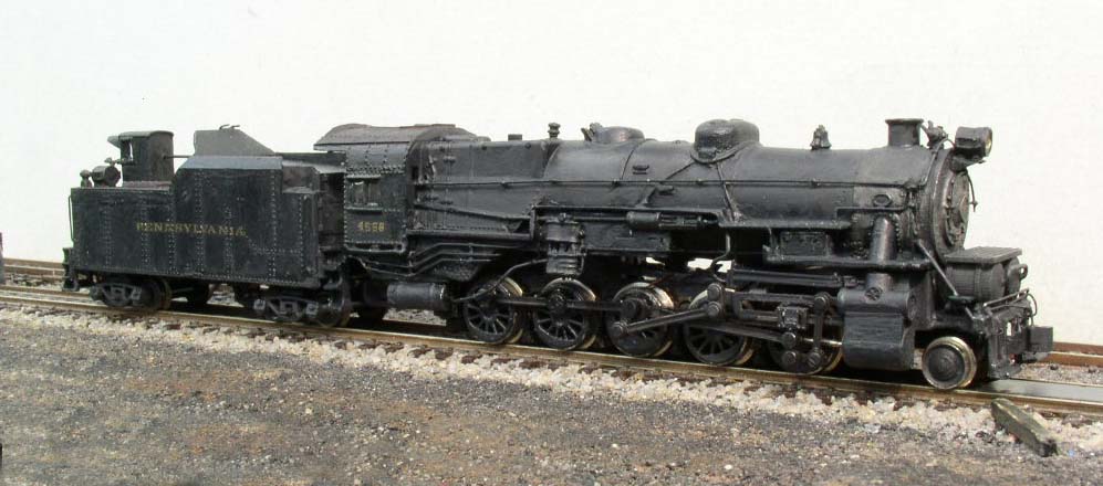

I've both painted rods and hit them with Neolube. Neolube can't possibly mess things up operationally as it's graphite in alcohol. It rubs off, but easy to reapply and you don't have to be particularly neat, either.
Believe it or not, this is Badger dark Brunswick green with a wash of grimy black, some black weathering powder, and neolube on the rods. If you look at the cab roof and tender deck you can see the level of grimy black wash. If you look at the stack on top of the smokebox that's the most visible portion of the black weathering powder. What I like about that is it's more effective on a dead flat finish than any paint.
link:
http://www.randgust.com/PRRL1025.JPG
Most of the photos of PRR steam in the 50's was a lot worse than this, but I'm going more for the pre-depression look.
