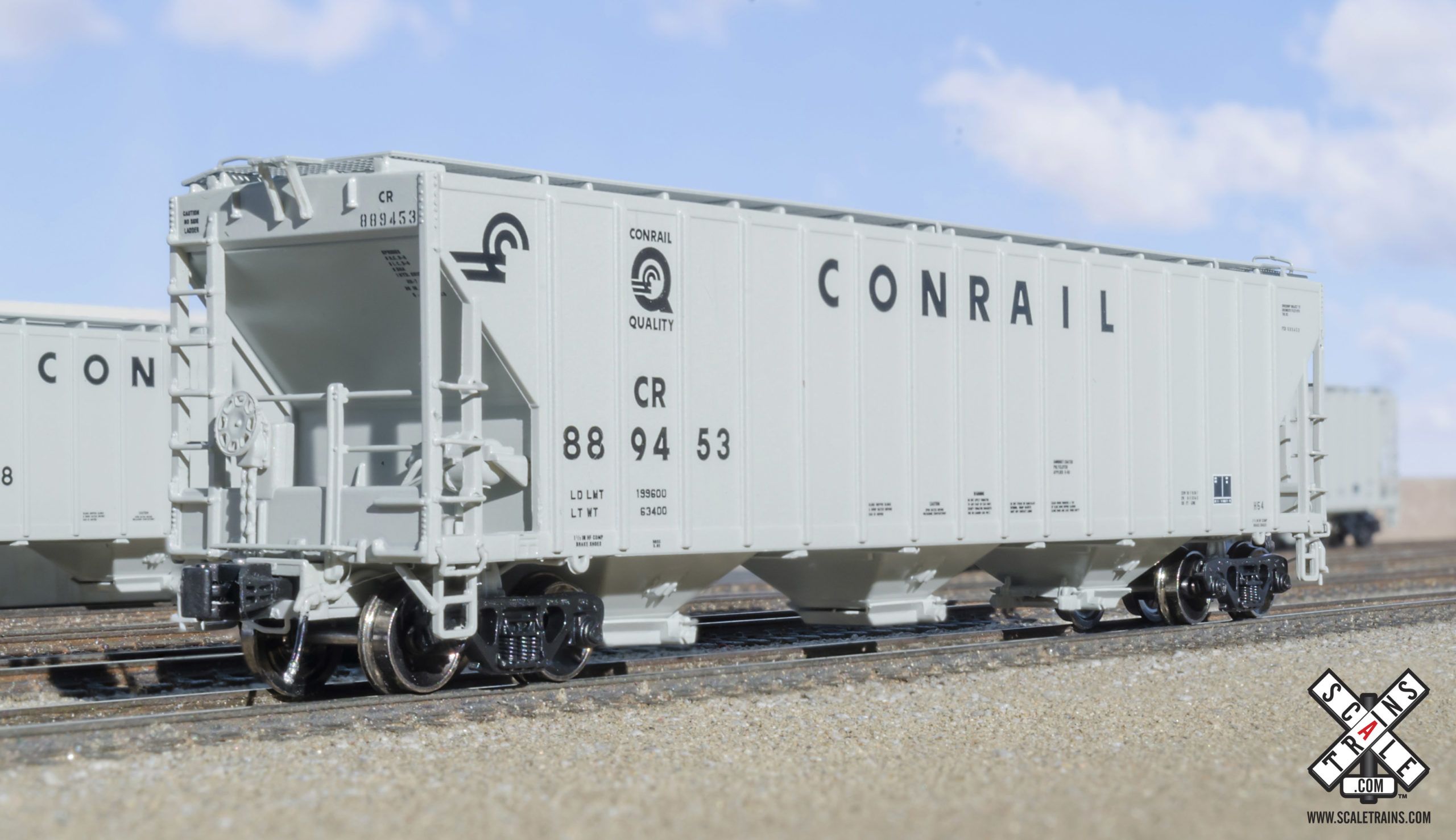

Do they really?
Yes, I saw the mention of this (very helpful for touch-ups thing) when I bough the GTEL Big Blow UP Turbine, but the Tru-Color UP gray and yellow paints shades were not even.  Other Scale Trains models I bough don't seem to mention the Tru-Color thing.
It's great as long as you mention what color of Tru-Color your matching to.
A UP Turbine it should be obvious..
But lets say I want to back date this to pre-Conrail Quality..
I remove the Quality logo and need to patch the gray.... which Tru Color Gray did they match to..
I asked but I don't think I got a response.
