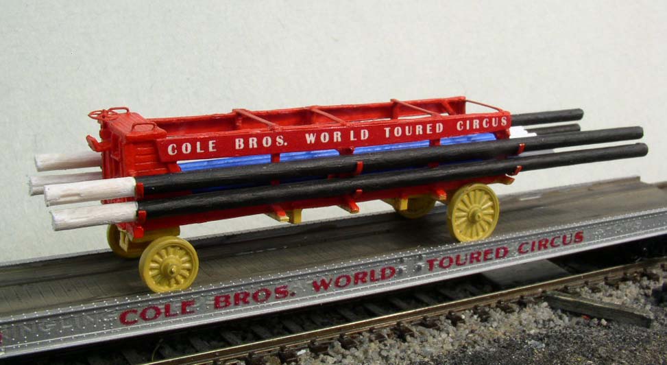

  • Posts: 3283
  • Respect: +3005
Re: Custom Decals
« Reply #29 on: October 23, 2024, 09:02:49 AM »
Interesting, but I still think you guys are working awfully hard with expensive tools.
I'm doing all mine with four basic things:
Clear laser decal paper
an old copy of Photoshop 7.0 (that still runs in Win10 but beware of the 'big disk' error issue)
Microsoft Word or Excel to simply print and resize .JPG's.
A color laser printer.   I have access to a Ricoh 2506.  Outstanding color and resolution.
Oh, and decal sealer, just to keep ink from scratching off.
The only really tricky part is printing in white (or light colors), I don't do it much, but when I do, it's a reverse image (lettering clear, going over white paint) and match the surrounding color to the equipment color.
But I've had really, really good results.
One of my tricks is to simply print out my test decal sheets on white paper first, cut them with scissors and check them for size and color.  I'll repeatedly do this until I get a sheet 'perfect' and then shoot it on the decal paper.
I tried and failed repeatedly with inkjet paper.  It's rubbery.  Even when sealed, it will bleed from underneath.   The laser stuff will put up with ANYTHING, including getting hammered with repeat doses of Solvaset and Dullcote.
This is as good an example as anything.    The "Cole Bros World Toured Circus" was scanned from a VERY old and yellowed Walthers HO set, and color corrected in Photoshop, reprinted in dark red.   It was also color reversed on a red background to match Floquil Caboose Red, and reverse imaged over white paint underneath on the pole wagon sides to get white lettering.   As it was all JPG's, those can be easily resized in any microsoft Excel spreadsheet or Word document, I set up a whole lot of little columns in Excel.
Link:  http://www.randgust.com/Polewagon09.jpg
I hope you realize how small that lettering is on the pole wagon, and how sharp it is.   I've done dimensional data this way.
The most outrageous application of this so far is the Cole Bros Circus advertising car; there's an oblique view of it in a book, fuzzy, black and white photo from 1914.  Had to be scanned, de-keystoned and straightened, reverse imaged, color matched to that bright red, re-proportioned to fit almost the entire side of an  old brass Western Railcraft RPO body.   That one I had to have help on with the Photoshop issues, but I got it.
Now, since I'm not selling anything here, and it's my own personal use stuff, I'm not in trouble with copyright issues.   That's important to remind people of.   That's what makes it possible to rescan old decal sets.  Even with the HO sets, I'm having to buy a set to do it.    This has come a long way since I actually carved up a rubber eraser with an xacto knife in 1972 to try to make a custom rubber-stamp herald for an N scale locomotive!
