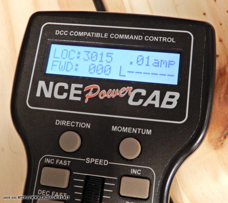

Few years ago I also made a similar upgrade to my Power Cab's display.  I found the display at a surplus electronic vendor.
Mine has blue letters on white background.  The camera didn't render the colors correctly. It is not light blue but just a standard cool white color white LEDs have.
I installed the small contrast adjustment SMD trimmer pot on the main PC board.
But looking at yours, I do like the white lettering on the dark background.  I might have to upgrade my upgrade!
