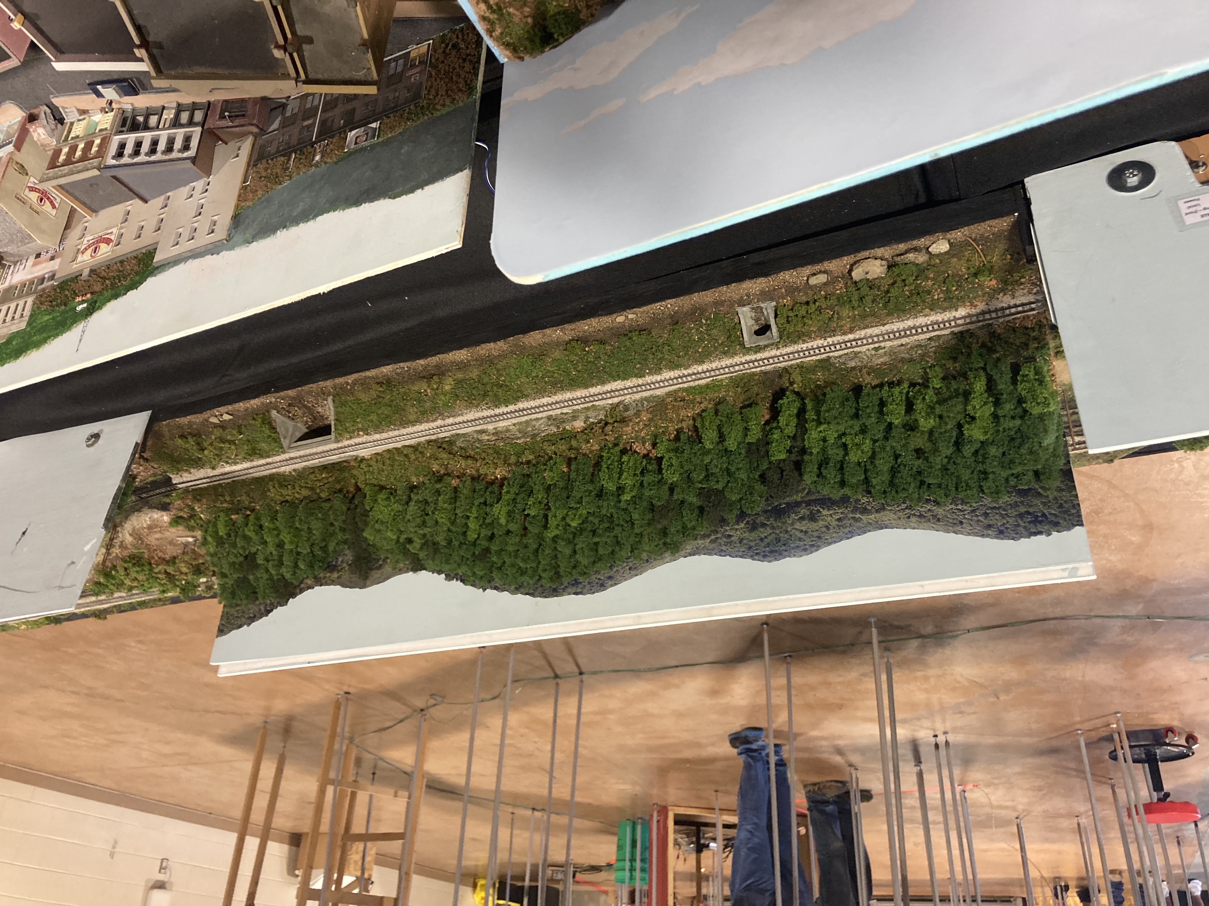

This is probably the easiest way to explain my oddball concept... this is my latest single-track triple, which is back to back to my other one (Hickory Bridge).   This is "Thompson", which is on the Allegheny River between R. Thompson and Thompson Island, right across from the house I grew up in.   I fished off those rocks on the left.   I remember the trains running up the river here.
Note it's built on 3/4" plywood base with roadbed ABOVE, which lets me have embankments, culverts, and the signature PRR concrete bridges.  And in PA, everything seems to be built in a drainage valley, the hills are steep, and on top, it's a plateau.   I shot the actual location and made a photo backdrop on the skyboard.
Front edge comes down to the river.  I didn't pour the water until 2023, this was at Altoona in 2022.
It's Peco C55 ballasted, on cork, with only short Kato adapters on the end.
There's a toggle switch on the back to set the track to either red line or yellow line, so it can be in front or in back.
Link:  http://www.randgust.com/Thompson%202022%20Altoona.jpg
Yes, that's Lee Weldon's Cumberland in front.
