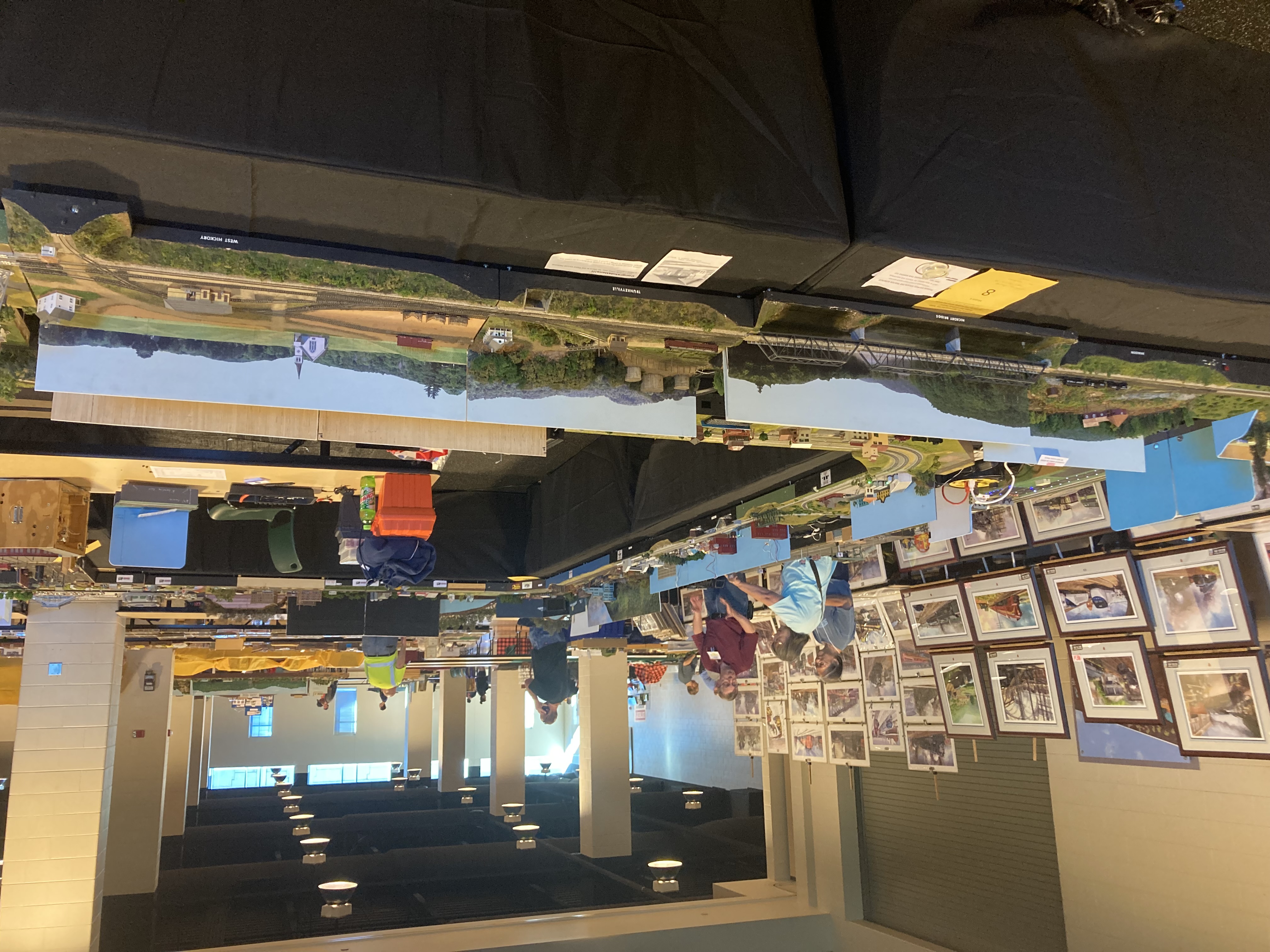

This is the lineup I now field at Altoona:
1)  Jamison - Double - working N scale rod-jerker oilfield with animation and sound.  This one splits the inner main to the backside
2)  Hickory Bridge - triple - but a single track bridge  - the beginning of my 'single T-trak' and if anybody else has done this speak up....
3)  Trunkeyville - double, fairly accurate module of Trunkeyville, PA and winner of the 2020 Ttrak virtual layout award.  Brings the back main to the front again.
4)  West Hickory - triple, not really finished, but has the Hickory Valley Railroad interchange and diamond on it (Hickory Bridge can attach to the front).  There's still a whole tannery that was here that has yet to be scratchbuilt, along with more company houses.
Because the prototype - the PRR Salamanca Branch - ran beside the Allegheny River over it's entire length, the line was dug into the hillside over most of the line with a steep bank down to the river itself.   In Ttrak, this meant that front edge had to slope down to the 'river'.   I didn't think this was such a radical Ttrak feature, but apparently it is.   The other thing of using primarily Peco C55 and Peco switches anyplace I can, and also attempting to show a radical difference in appearance between the normal single-track ballasted main line any a parallel cinder 'siding/yard' are different, and the development of a single-track Ttrak split design to front and rear with a divider in the middle. I've painted the Kato switches black to match the cinder ballast too, which is a PITA but worth it.   And the first time Dave Ferrarri saw the double 60-degree crossings across the main at West Hickory module, he kinda flinched.   On that module, that allows my logging railroad portable layout to be connected here, as that was the interchange with PRR.   They are Atlas 60's but have worked just fine.
Link:  http://www.randgust.com/Randgust%20modules%20Altoona%202023.jpg
