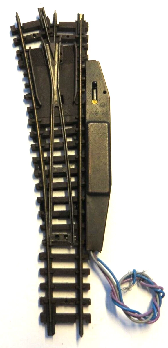

In N scale we lived with plastic frog commercial turnouts since N scale's infancy. I believe only when Shinohara C70 track was introduced we finally got metal frog, and this was before DCC, however that track system was never really widely accepted.
Weren't there turnouts with metal frogs that predated Shinohara code 70 track?

LOL, yes, I sit corrected.  That looks like Arnold track.  The rails did not look like anything resembling rail profile and the (movable) frog was stamped from thin sheet metal as a single piece with the points, but it is in fact a metal frog.  :)
You also reminded  me that PIKO (back in the day in East Germany) had a similarly designed turnout.  PIKO rails were fabricated from U-shaped thin sheet metal.
Arnold Rapido track is what I began with back in the 1960s.
The rail had what Arnold referred to as a "self-cleaning" profile, with a relatively narrow top, that was supposed to remain cleaner as compared to rails with a flatter/wider top that was more prototypical.
Also, as I recall, the frog was designed such that an Arnold wheel (which had a deep flange) could actually ride on the flange as it traversed the frog.
Yes, they did tout that rounded railhead "feature" although I'm not sure how well that worked in reality.  But the rail itself was not anywhere close to prototypical rail.
Well, actually this is still the case with PECO and  other brands of commercially made turnouts with overly generous flangeways. The "toy-train" wide tread wheels travel over those frogs the way they supposed to (the treads are wide enough to span both the wing rail and the nose) traveling smoothly through the frog. But when more modern wheels with narrower tread and low flanges travel through that frog, the tread is not wide enough so the wheel drops down bottoming out in the flange, causing the rolling stock to dip down and come back up when the tread finally climbs back onto the railhead.  I'm sure that in those older turnouts the flangeways were even wider, so the wheel flanges were riding in the flanges while traveling over the frogs.
