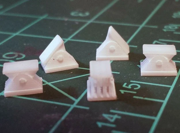

This is simply outstanding Tim!
PM your mailing address and I will donate some of my extra pivoting bridge shoes for the diorama if you are interested.  They look like they would fit well from the bridge images above.
Here they are installed on my elevated structure:

Thank you John!  I will take you up on your kind offer and will send you a PM.
Bridge shoes have arrived - thank you John!
