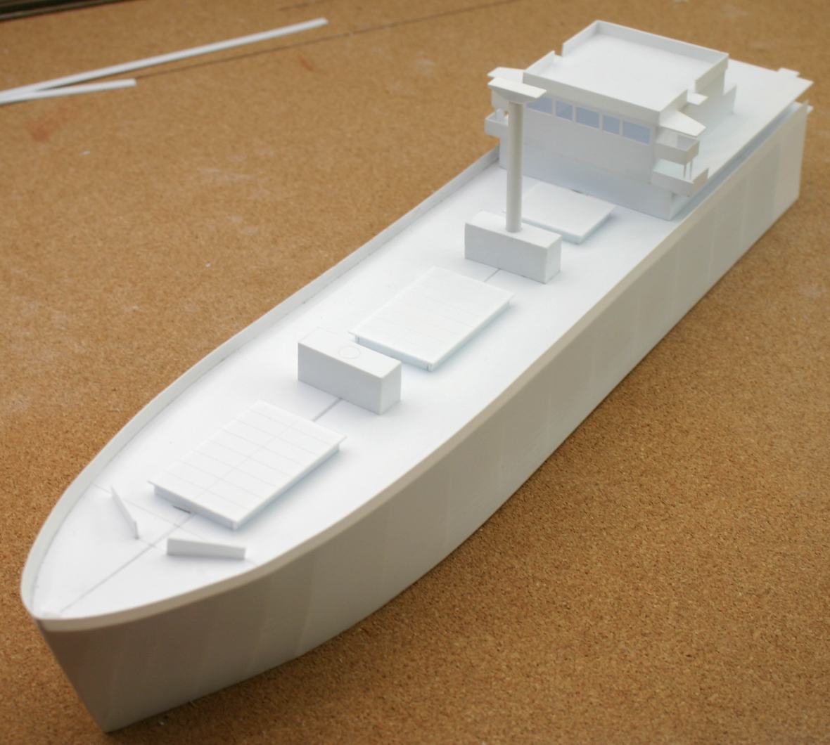

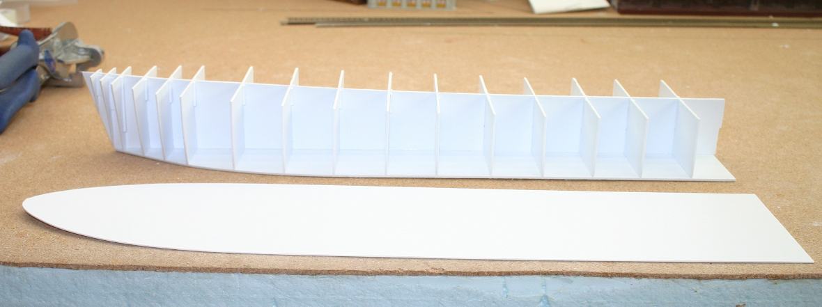

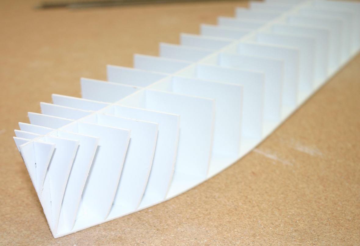

So Wed, Thurs and Fri evenings I began cutting out the pieces for the first Liberty Ship. Ran into a few snags as the plastic sheet is too hard to grip and cut multiple passes. The cutter lost registration when it homes over the 24in length. So only one pass will have to do. I switched from .020 to .040 for the deck as the thicker sheet has more bond area for the sides and did not flex like the .020. I found that I could trace the cut from the cutter with 1 pass of a knife and then snap out the parts.  For the .060 bulkheads, I did not like band sawing them so 2-3 passes with the knife and snap. The slots in the keel and bulkheads were done on a bandsaw. The .080 base did require 4 passes before I could get a clean snap.
The hull sides were .020 sheet. All of the deck structures were cut from .030 sheet and glued together. I will be making a brass detail set for doors, hatches, ladders, railings, etc. Other ships will get a different design so I can have the cargo hatches open.
