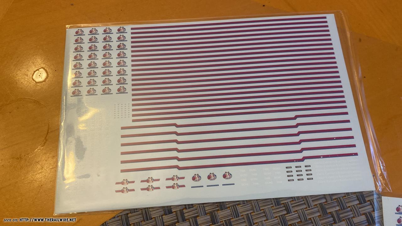

I found some pics of the paint process that I forgot to include so I’ll take a step back.
After I got the decals from the printer…..
…..I made masks that matched the contour of the stripes on the Ultradomes. I drew them in Inkscape and then printed them. I cut them out and taped them to strips of frog tape which gave me perfectly sized masks for each of the four sides of the cars.
The cars were painted in base coat of Rustoleum white primer and then several coats of Vallejo white. Once the masks were applied I shot another coat of white to seal the tape. This was very important as the decal stripes could mask any imperfections on the bottom edge but the top edge would be right there in your face.
The result after shooting the blue was exactly what. Had hoped for.
Ok that’s all for paint.
