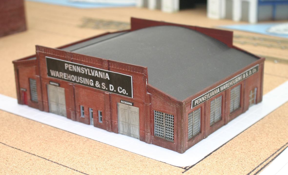

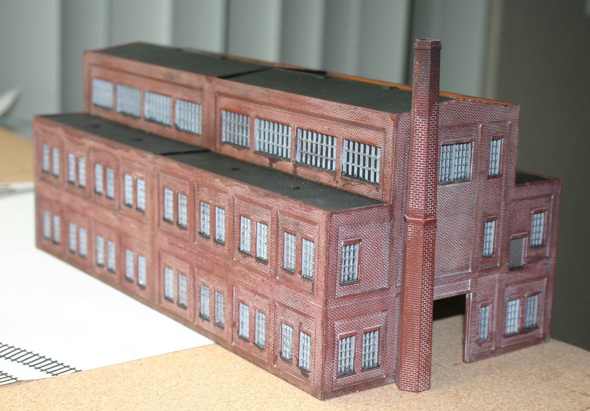

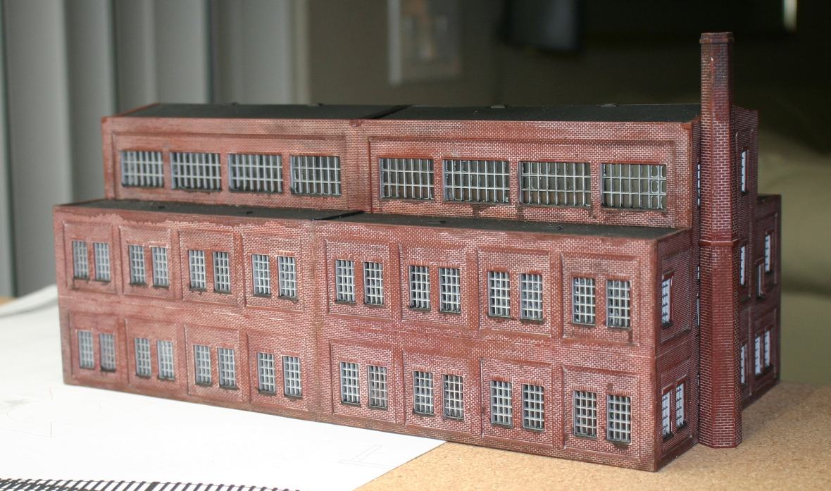

Still working on the first building of the iron works, but I am nearly done with the construction.
Been rattlin the knoodle on the issue of sidewalks. Here are N-Scale sidewalks from CMR and the slabs are 37in sq (yeah, the glare make it impossible to see the etching). To use the N, the buildings would have to fit inside the sidewalk which presents a problem if there is a recess like the freight doors.
On the other hand, here are HO from CMR which would have a 6ft sq slab and they are wide enough where the buildings would sit on the sidewalk. After some frequent starring at the differences, the layout will get the HO.
Regards
