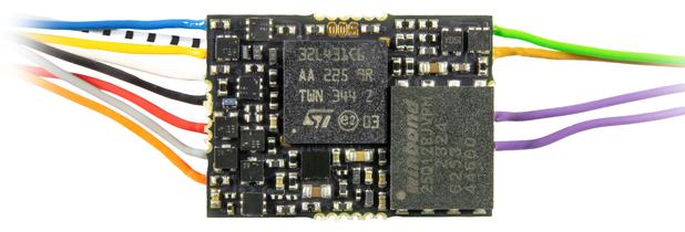

. . .and said the the smallest Zimo decoder MIGHT fit in the switcher but he didn't think they were easily available in the US if at all.
They kept referring to the survey, but it came across as cherry picking. I'm sure that's my biased ear though.
That is such a load of poo!  ZIMO decoders are available in USA (just as easily as any other European brand like ESU). Smallest ZIMO sound decoder (MS500) is likely the smallest (16-bit) sound decoders available out there (by any manufacturer). 14 x 10 x 2.6mm.  Even their Next18 sound decoder (MS590) is 15 x 9.5 x 3.3mm. Maybe they are talking about the width?
It does appear that the BLI folks live in their own little world.
