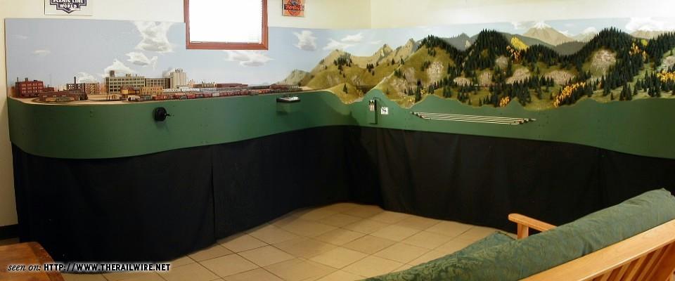

Working on fascia, turnout throws, and skirting:
More on The Carolina Sandhills Lines thread in the Layout Engineering forum.
Hey Dave,  I took a double-take when I saw your photo.  It would appear you and I have the same good taste in selections of fascia and skirting color.   :D
