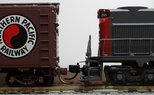

I'm having some height issues with the rear coupler that have resulted in some random uncouplings -
Front coupler is fine. Anybody else run into this?

I'm thinking I could probably fix it by bending that protrusion off the chassis where the coupler box screws in. But yikes, it looks breakable.
-Mark

Oh, it sure as heck looks like it'll snap off the moment you put real pressure on it. Since it's a cast metal of some sort, it's going to be brittle.
If you can, hold off until later this evening. I have one of mine apart to trace wires and can eyeball the frame-body situation. I'll also check the other ones to see if they have the same issue.

Since the coupler is too high, maybe just add a styrene shim between the top of the coupler box and the chassis.  Hopefully this is one-of problem.
Like Mike mentioned, I would not attempt to bend down that pot metal  frame.  Instant breakage!
The truck might not be properly installed. Are both couplers too high, or just the rear one?

Just the rear one. Here are three I have (a fourth is disassembled). As you can see, one of the rears is misaligned. No clue about the problem until I take it apart.

Evidently my issue is with the actual coupler. I put the bad rear coupler on the front and the problem followed it.
-Mark
