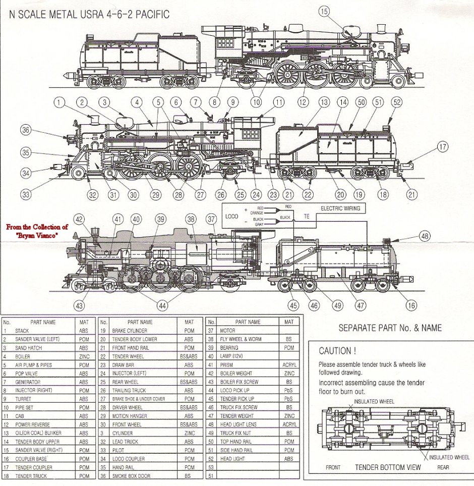

I picked up an MRC/Model Power Metal 4-6-2 Pacific at a train show.  The model is in great shape for the most part.  A wire to the driver pickup wipers was broken and the wiper contacts tips were bent. A known problem.   While cleaning the engine I broke off a piece of the Loco pickup wiper Part number 44. The piece that broke off was the extension that was added to collect current from the rear two wheels on the pilot truck. These are the MRC advertised "improved" silver driver wipers!  Does anyone have or know where I might get replacements?  Or since these wipers are known to have problems has anyone done replacement upgrades for improved pickup?

Here's the exploded drawings. I think you're looking for 44. Hope that might help some:

Honestly, I would not expect MRC to be very forthcoming with a part like that (or any part for their steam locos).
It looks like it could be soldered back together pretty easily.  Just tape the two parts down firmly on a piece of wood,
apply a dot of flux, and solder.  I'd suggest adding a thin bit of brass strip across the joint and soldering that on as
well to it won't flex and just break the solder joint off, which will surely happen eventually without that splice reenforcement.
