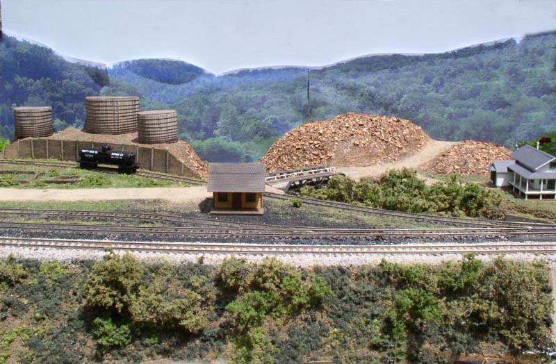

Oh totally that's what's frustrating me. Im like these things look like crap. I want to get a leaf brown ground cover to put under them. I might have to make my own concoction for fallen leaves to go under them.
OK, so another contrarian thing.   Get an old blender from the thrift shop, fill it up with REALLY dry leaves (can't be dry enough) and chop them up to about a powder.   Paint earth brown under them, and them put them down just like normal 'turf' with diluted white glue.   Only put them down where they would be forest floor.   Add more litter like branches, etc. on top, but I guarantee the leaf color and texture for the forest floor is spot on.
I did this on my Hickory Valley module back in 1976 and it still looks good today.  No, it didn't mold, ever.
Another tip, don't use your wife's good blender, and if you do, don't get caught.
On an eastern forest, the only time you can even see the floor is at the edges and looking in.
Before:
after:  (I use Woodland Scenic turf on actual dried twigs for background stuff, Woodland Scenics fine foliage for the foreground and bushes.)
Oh, and that dirt road?  Dirt.
