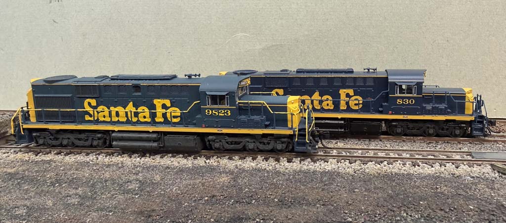

I'll post this here too just for the record.
The one at the back is 'stock' BLI, the one in the front is after I got done messing with it.   That's the air intake for the dynamic brake, repainting in Floquil Santa Fe blue (note the difference in color), radio antenna, detail painting, renumbering into the 9800 series (1970 renumbering, I'm doing 1972).   Weathering to come at some point, they were getting a little grimy by '72.
Link:  http://www.randgust.com/RSD1501%20comp1.jpg
Ill be the first one to say how much I am NOT a BLI fan, greatly disappointed in the PA1 performance, but these are much, much better.
The model is really very good, I only have some personal gripes in using ACC to glue everything together (like Intermountain) and in the decision to put a decoder in everything instead of making it DCC compatible with your choice of board.  I was reluctant to get one, then after I pulled the decoder, added weight and tested it, I was sold and got three more.   Great performance, very good drawbar pull.
So if I was Atlas, just saying, I'd invest my R&D funds elsewhere.   Relatively few flaws in this execution, and all fixable.   And this from a long time Kato and Atlas fan.  My very first BLI units.
