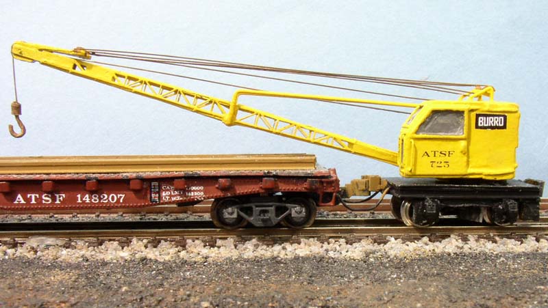

This is an old shot of an even older model. I think I made this back about 1975 and had it in my shop scene. When I went to this layout I decided to come up with a short work train with this as the 'feature' car so I had to lay the boom down. ATSF tended to use older stuff for boom cars, a drop-end gon worked fine. But as much as I studied it, couldn't figure out how to power it, you get a special prize for pulling that off.
More along the line of what you've down was powering the Burro crane and tying it to a flatcar full of rail (no coincidence, I needed the weight for electrical pickup on the flatcar). There's a build thread on this somewhere. Actually runs very well, still the smallest powered thing I've ever made.

My original build had the boom up about 30 degrees as it was a shop scene. When that was scrapped, and I made the crane a 'car', the boom was too high to clear overhead obstructions and it took some serious surgery to figure out how to lower it, as I'd ACC'd all the thread cables in place.
You can see on mine how low I set the boom, it now clears my highway overpasses, tunnels, and signal bridges. I'm not sure what your overhead clearances are, but check that now instead of later.
I did note that in my actual ATSF employee timetables of the period, any wreck or work train with a crane in it was limited to 25mph. The first American 25-ton crane I saw ever running under it's own power was a PRR one dispatched to a wreck/tank car explosion at Starbrick PA in the 60's, and it was just 'flying', with the boom oscillating back and forth and the hook swinging wildly, but it was an emergency situation.
I'm also a big advocate now of .010 wire as cables instead of the thread in that kit. Compare the Stewart photo with the Burro photo, the Burro was done with .010 wire bent and ACC'd in as individual segments.
