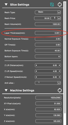

As long as you're going to the trouble of printing a frame adapter, you should definitely include a pocket with it.  I can send you some .stl files that could help get you started.  You'd have to adjust the dimensions to accommodate your coupler of choice, but it's dead simple to do in TinkerCAD.
By the way, I'm not sure why your frame part looks so "soft" but it looks like you printed it flat and that the side we're seeing in the photo was the bottom of the print.  Might I recommend that you rotate the part by 45 degrees before you add supports and slice the model.  You can get much sharper corners this way, and if your voxel resolution is good, you won't notice the layers.  One tip though: with this approach, it's helpful to set your z layer thickness equal to your (x,y) pixel size.  For example, on my Mono, the (x,y) resolution is 51 μm, so I set my z layer thickness to 51 μm (instead of the default 50 μm).  This really helps keep aliasing to a minimum for surfaces that are ±45 degrees off vertical, which makes it easy to get sharp surfaces on all 6 sides of a part with mostly cubic geometry.  All of my conversion parts have been printed this way.
The specs for the photon  -- so if I follow -- I should set the Z for 47?
Technical Specifications
    ● XY DPI : 47um (2560*1440)
    ● Y axis resolution : 1.25um
Correct.  (I assume that second line should read Z axis resolution, not Y.)   You could also make it any integer multiple or divisor of 47 and keep aliasing low, but larger would be noticeable and smaller (e.g. 23.5 μm) is overkill and would take forever to print.  For reference, here is a grab from my slicer software:
(Sorry for all the Tech Talk in Weekend Update.)
