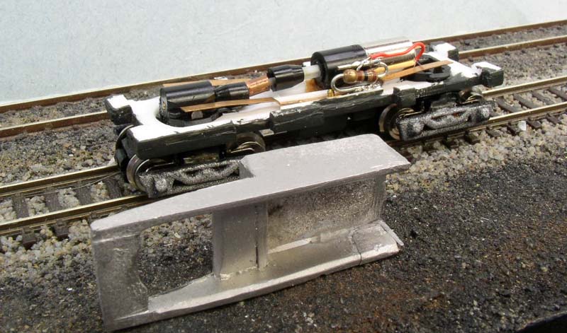

Randy Stahl gave me the challenge of figuring out a way to power some Shapeways-printed electric boxcabs.  This is the 'hybrid' battery-electric 756.  The body and the truck sideframes are resin printed off of Shapeways.   I designed the mechanism from Tomytec parts, Atlas pickups, and a GM15A gearhead.   I designed and resin printed the frame as well as the custom cast body weight.
If anybody wants one of these either as a kit or a prebuilt, contact me - I do the frame and cast weight that fits the body shell.   The other one (with even narrower hoods) is under construction.
The low end hoods on these things really present a challenge to fit any motor at all and this is really tight.
