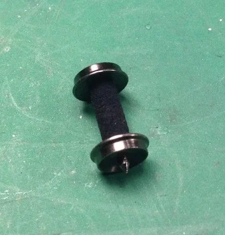

Has anybody made 2-rail pickup wheel sets by cutting the uninsulated wheels off something like Fox Valley or BLMA wheel sets and putting 2 insullated wheels in-gauge with a plastic sleeve?  Seems doable, but I have not had to try that, yet.
@Maletrain
http://www.keystonedetails.com/keystone-customs/2016/9/12/n-scale-axle-muff-20pk-for-fvm-axles-58477
