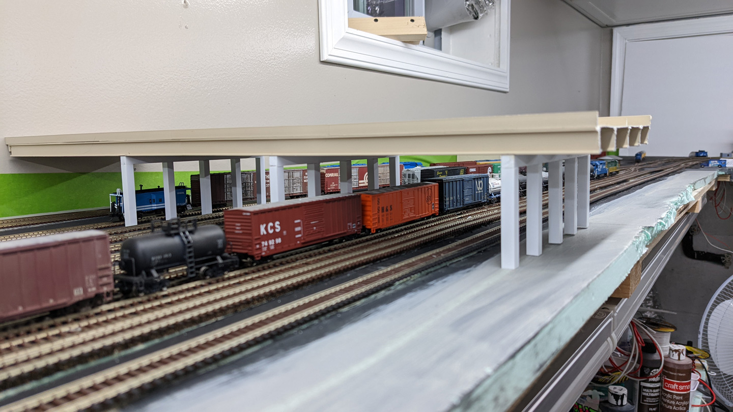

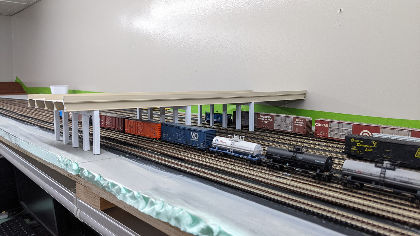

I have a few yard tracks still to glue down. I wanted to rebuild the I-83 bridge before I finished things up in case anything needed to move.
You can see why I needed new piers in addition to cutting down the depth.

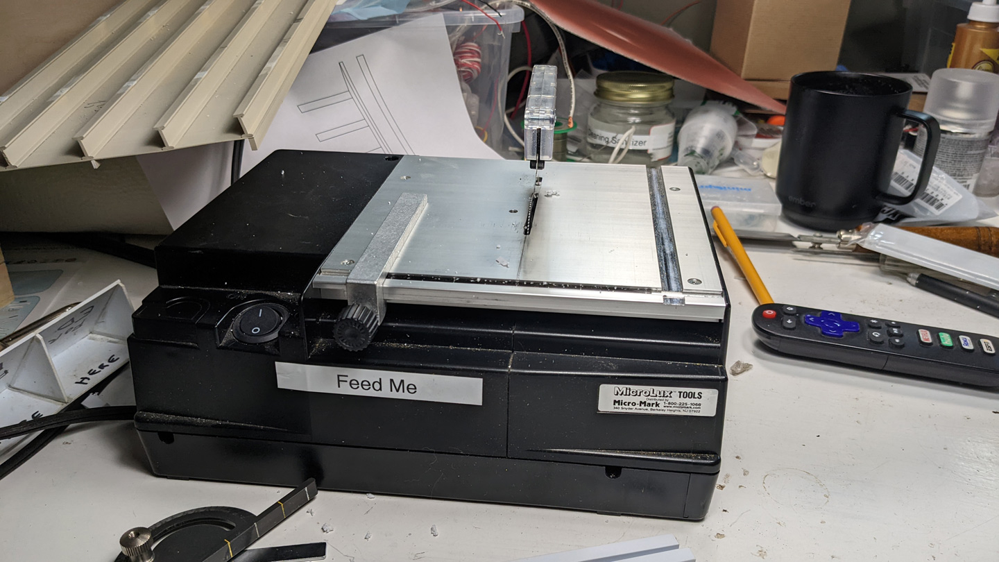

So last weekend I got some new plastic and cut up a bunch of new pier pieces using my mini table saw.
Don't worry, I didn't leave the fence in place while I was cutting them. I setup a stop block instead.
I used the saw to cut the deck down to the right depth for the new layout size too. It really IS handy.

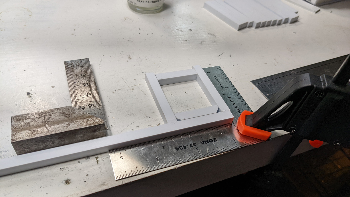

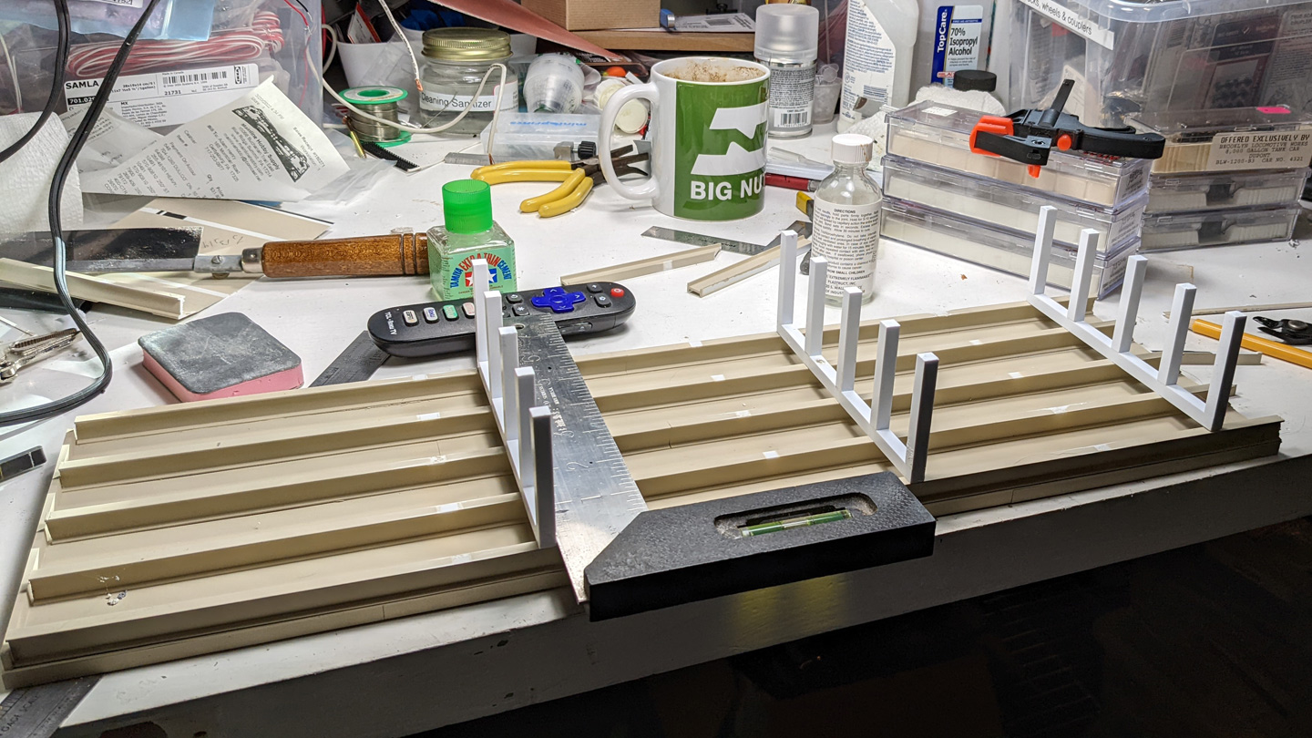

I also cut up some spacers to help with assembly. Here's everything being glued up.
Then just tip everything on its back, get out the square, and glue in place.
All done and ready for paint:
Oh, I'm certain there's a prototype for this somewhere.

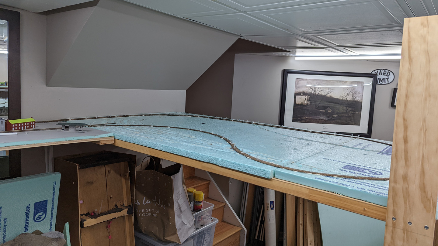

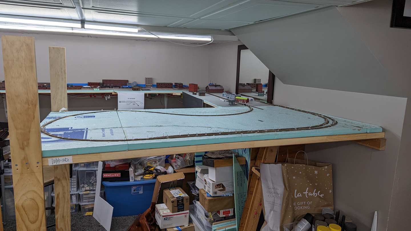

« Reply #793 on: April 27, 2022, 11:27:59 AM »

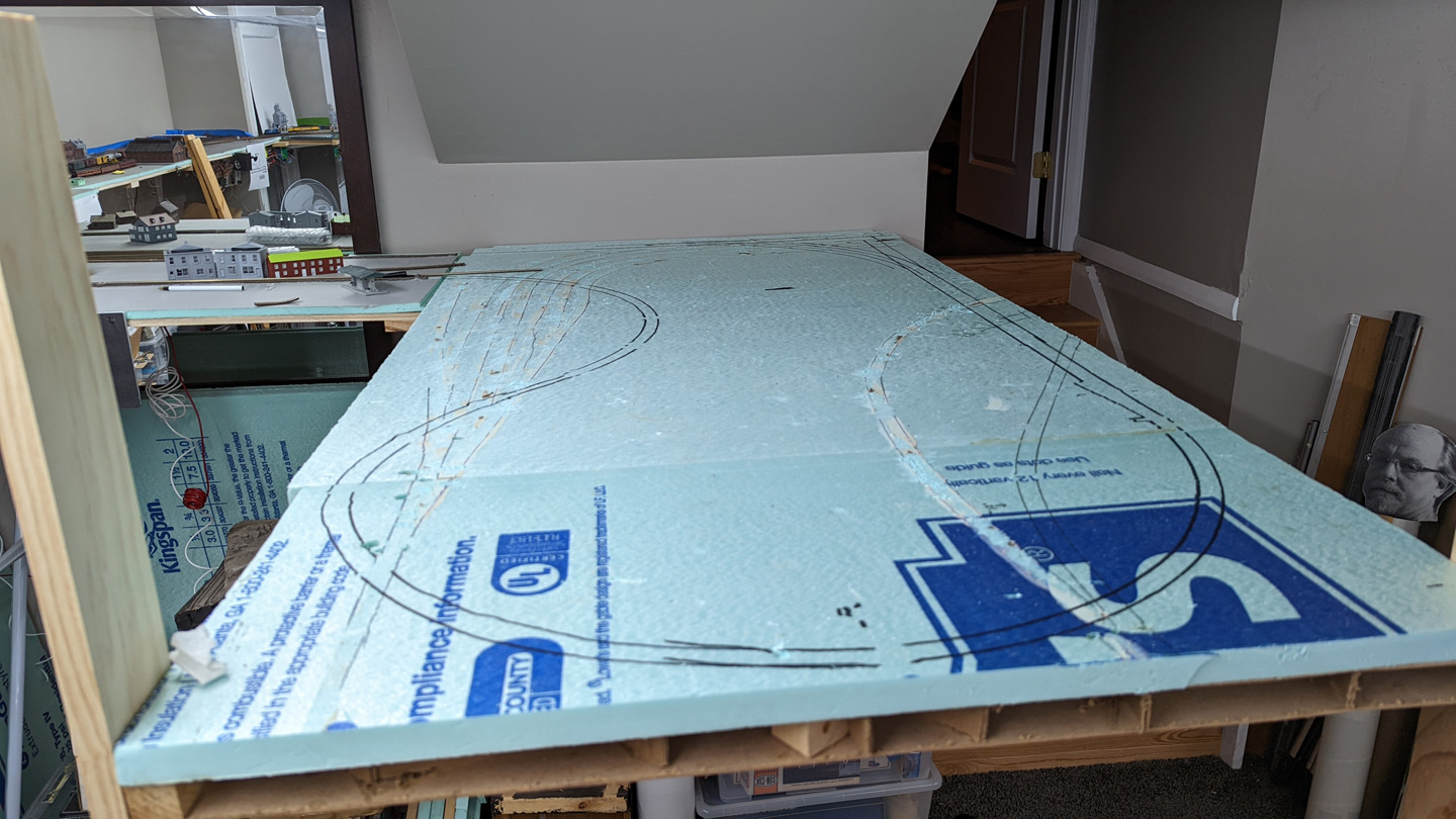

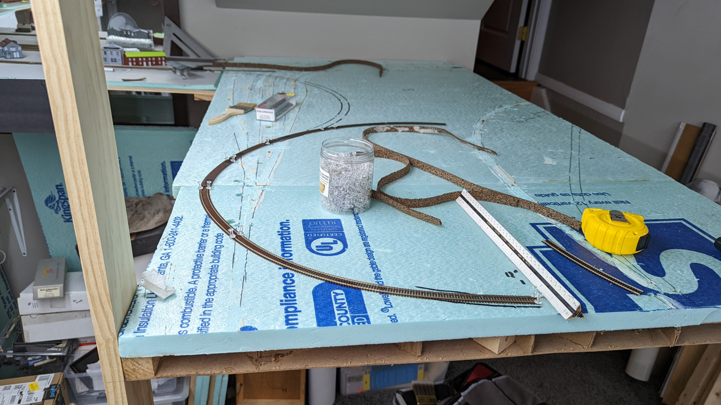

I've been debating on whether to start building the rest of the actual layout or to toss up some temporary loops and JFRTM for a bit.
Guess which approach won...
In the spirit of Earth Day (and being lazy), I realized this was a great opportunity to reuse some of the benchwork I had prepped for the old Coal Country layout. In this case, the door I had cut down was perfectly sized for what I wanted.
I added a cleat to the wall to support the door on one end and have two 1x4s on the other. If this were going to be up for longer I'd probably build in some more support but future sagging might be the impetus to "get on with it" if I get too comfy just running around in circles.
Here you can see my process for laying out the track plan. I have a set of 15" radius snap track that I use to ensure I'm at the right size (or larger). I laid it down and traced it out.
Then I spread out some Liquid Nails for Projects and put down a single piece of cork. This was then pinned down with "professional" push pins.
Glue should be try today, but before track laying begins I think I need to adjust the height of the whole thing by a smidge.

Out of curiosity Ed, how long do you think you'll keep the loop around until you start prepping for Hanover Jct and the transition to the lower level?  Thoroughly approve of your concession to JFRTM; you can't let that CR Blue collect dust when it should be collecting soot and grime!
