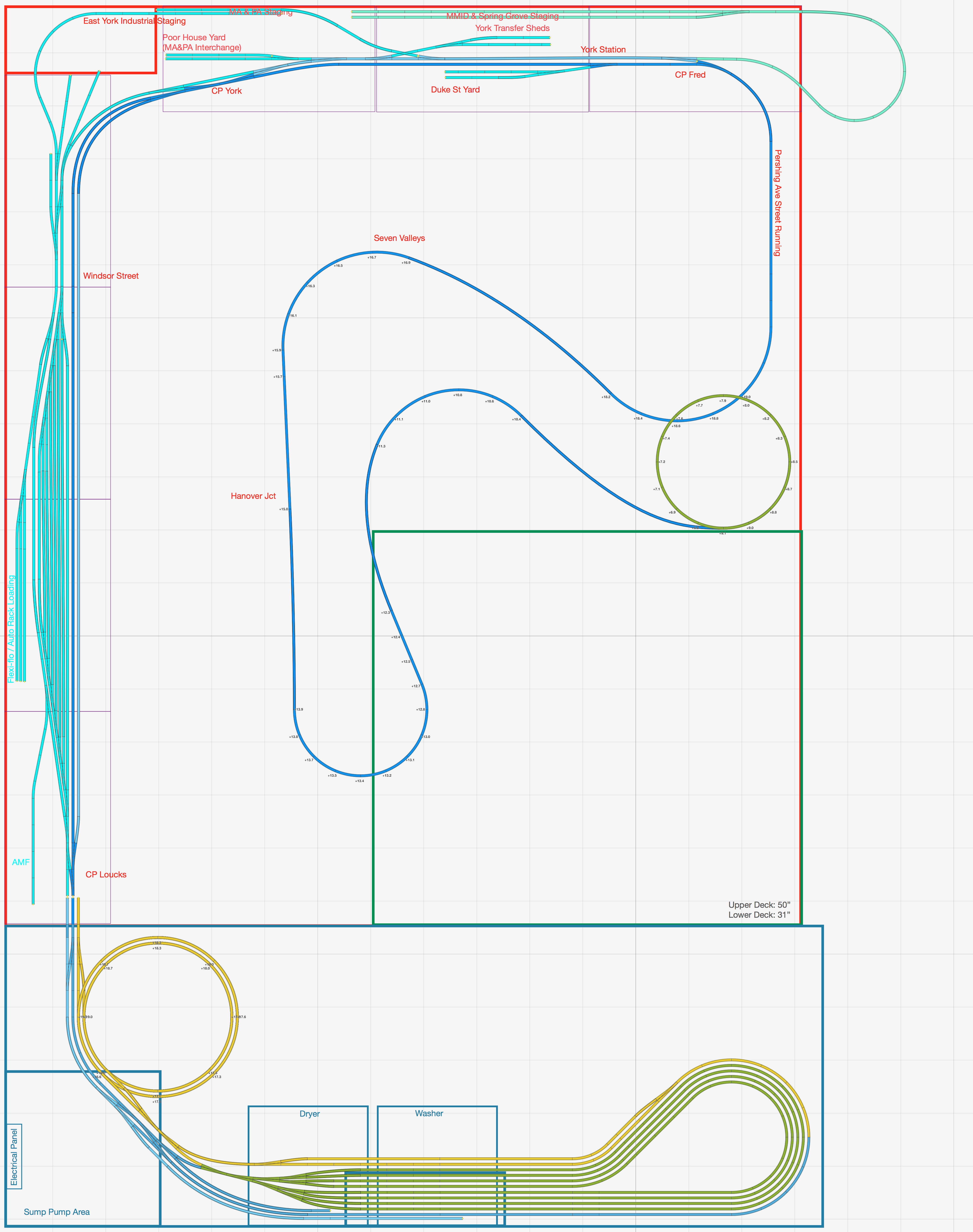

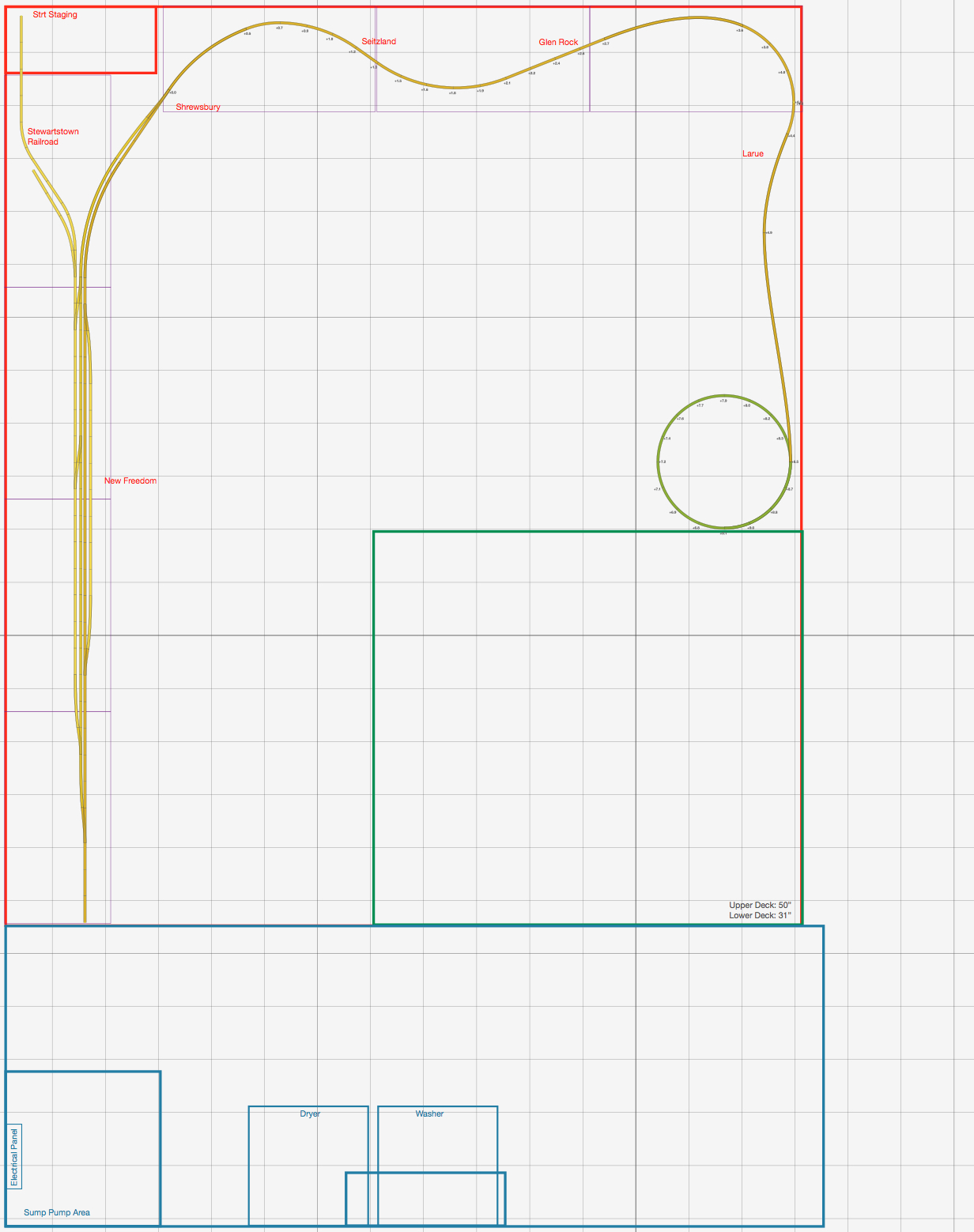

I'm continuing to review the layout plan and keep making revisions.
I'm excited that I figured out how to get better staging in place for the branchlines and MA&PA interchange in York: put them behind the backdrop! I know, I know, this is risky, but I'm willing to take some steps to mitigate the risk (like having a low backdrop to screen the area that I can easily get behind).
I adjusted the Windsor St Yard track some. CP Windsor is gone. I don't want to deal with building the interlocking and I don't think Conrail would've either when there was another easy way to accomplish the same thing it did (by running trains that need access to the yard up the yard runner).
I've lengthened the street running by realizing that the track there can go above the helix (it'll be about 10" down below track level there).
I've switched as many mainline turnouts over to #10s as possible. I figure SD40-2s and 89' flatcars will appreciate those.
I have also adjusted the mid-run Choadlix to only be a single turn. As I made adjustments the grade was flattening out and even with a single turn here it still gets me 2.5% as the ruling grade.
Not much has changed on the lower level, but I did make some subtle improvements to the Stewartstown interchange.
One thing I'm struggling with is the shorter double ended siding in New Freedom. I'm planning that to be where helpers hang out, but I'm not sure how best to plan it from a signaling perspective. I think it'll be more fun to make the switches into it hand throws that need to be unlocked, but I'm not sure about that.

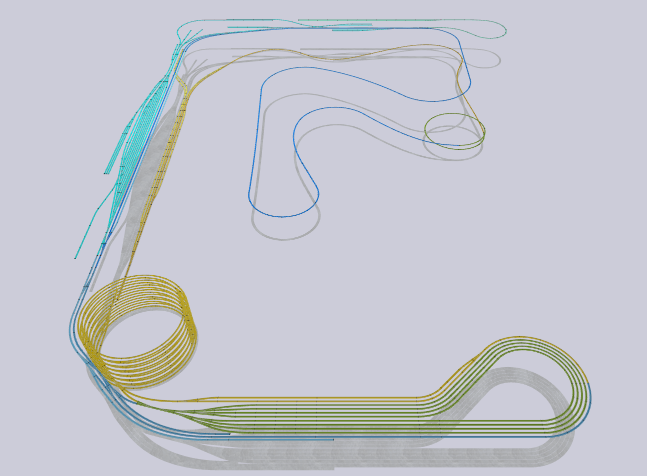

And here's the whole thing in 3D.
This weekend I plan on doing some more room repair, including replacing the window (now with Lee's blessing) and hopefully picking up some materials from @mu26aeh I'm getting close to benchwork time. I can almost taste it!

Just remember the Tony Koester rule of staging.  Take what staging you think you need, multiply by two, and then add one, and that's what you build.
In your 1985 era, is the original M&PA still intact as far as Delta or to Red Lion?  Or in your world did they still operate the former PRR from York to Hannover like they did under Emons?
My thoughts on it are that they hung on the way they basically did until Emons: serving a small fragment of their former empire, maybe as far as Red Lion. I'm only planning on handing off a few cars to them at any time, but I really like the fun it'll give the dispatcher when they need to get railroad to come out and get their cars which, of course, have also had to have been set off by a local.
Make that section of the backdrop in front of any hidden staging tracks a removable panel and build a pocket in the benchwork so that it can be easily dropped in and pulled out.
Put rerailers in the tracks on either side of the turnout leading into the two hidden MMID staging tracks.
Almost EXACTLY what I was thinking!
