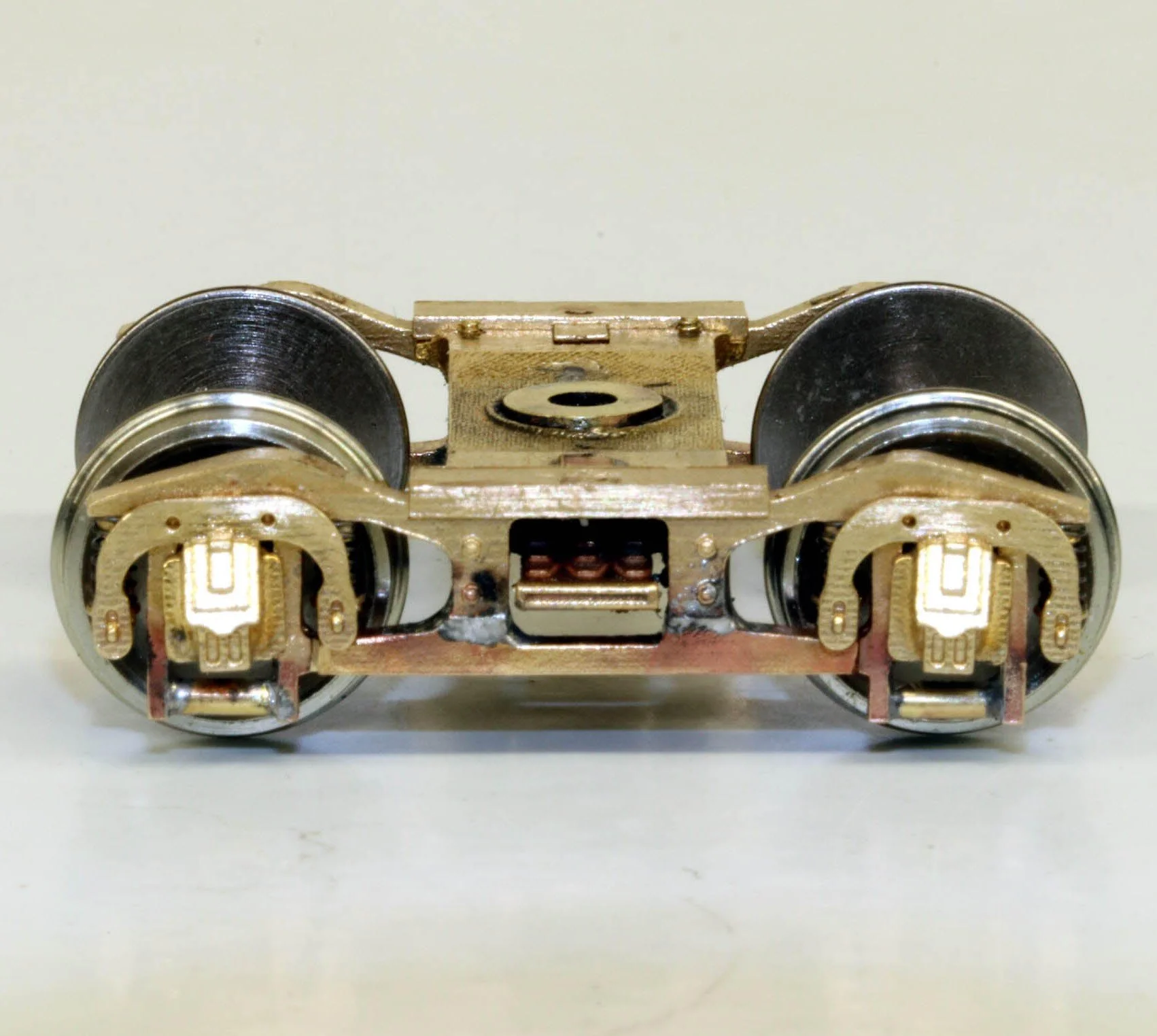

@Lemosteam  the brass pilots I had made for another Climax didn't shrink much at all. At most the part is about .0015" smaller than I drew it.
The amount of shrink grows with length, width and height.  The longer wider and taller the design, the more shrinkage you will see. (TWSS right?)  Anyway, hopefully none of your fit dimensions will have a problem the rest is all proportion.
When I did the S scale sideframe, bolster and journal kit here, the 2% allowed all of the parts to fit properly after shrinkage, and yes the journals are sprung.  We compared the castings to my enlarged CAD and we saw on average 1.5%-2% depending on the dimension.

I went 1.5%, hope it works. I'm mostly worried about the couplers hitting the trucks.
