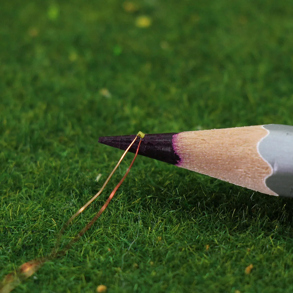

Inspired by @DKS and @wm3798 i recently ordered some pre wired smds to do building lighting. I may have gone too small as I can see the polarity Mary on the back (!) but in for the proverbial penny I want to see what I can do. So, here’s an enlargement of the best photo my iPhone could get. Anyone got any idea which side is such?

In the photo, you will see a green line.  Note that you can just barely make out the fact that there is another green line intersecting it on the right - like a "T" lying on its side with the "stalk" of the T pointing to the right.  That's the Cathode (-).
But these things are so small that seeing the "T" and which way the stalk is pointing is really difficult.  SO . . . using a 1.5v battery to see which way the leads make the LED light up is preferable (and you should test them, anyway, before using them in a project).

« Reply #4 on: August 22, 2020, 12:29:48 AM »
Yes, like John stated, LEDs have their cathode identified in some way. The "T" he mentioned is one such example. Sometimes there is just a color bar (usually green) close to the cathode pad.  I have also seen a triangle with the point facing cathode. Sometimes there is also a cathode identification mark of some sort on the lens side of the LED.
A 1.5V battery might dimly turn on and illuminate the standard red, yellow, and green LEDs (which have forward voltage rating of 1.7-2.0V), but I doubt that any white, blue, or true green LEDs will light up from 1.5V.  Those have forward voltage around 3V.  A 3V lithium coin battery (like CR 2032) could be used for those, although I would recommend adding a 100 ohm resistor in series to limit the current passing through the LED.  I'm being overly cautious because  that battery cannot supply much current, but those really small SMD LEDs (like 0201 or 0402) have very small operating current (usually around 5mA).

« Reply #6 on: August 22, 2020, 12:43:48 AM »
These were done with magnet wire so both wires are the same color - though I suppose I could sharpie it.
Are both leads indeed the same color?
One of the vendor's pictures shows the anode lead having what seems to be clear insulation while the cathode lead has red insulation.

Re: Identifying polarity on SMDs
« Reply #8 on: August 22, 2020, 08:17:10 AM »
I've got these same LEDs, although possibly not from the same vendor. After testing, I found that the lead with clear insulation was the cathode.
Sometimes polarity is indicated by lead length. If one lead is shorter, chances are very good it's the cathode.
Also, some LEDs have resistors already wired in. Most of the time I've found that the resistor is attached to the anode.
« Reply #10 on: August 22, 2020, 02:11:42 PM »
So, post coffee -
  • These SMDs have different length leads.  SMDH  :facepalm:
  • Even if these have differing color lacquers for insulation, I can't tell the difference.
  • I have 2025 3V batteries for our car key fobs, and holding one vertically in a small all plastic spring clamp makes a decent test rig.
So far I only have one bad SMD.  But getting good contact is not easy owing to the insulation lacquer. What have we decided is the right removal protocol?
