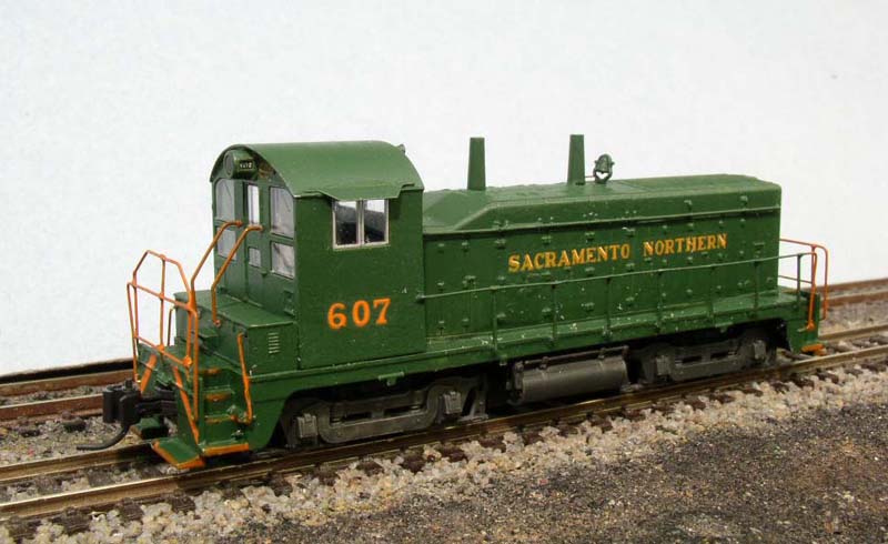

Late arrival.   Customer project for a repaint/decal of a Kato undec shell plus a full custom wire handrail program.   Those rear handrails on the NW2 are pretty unique.
