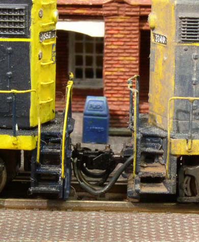

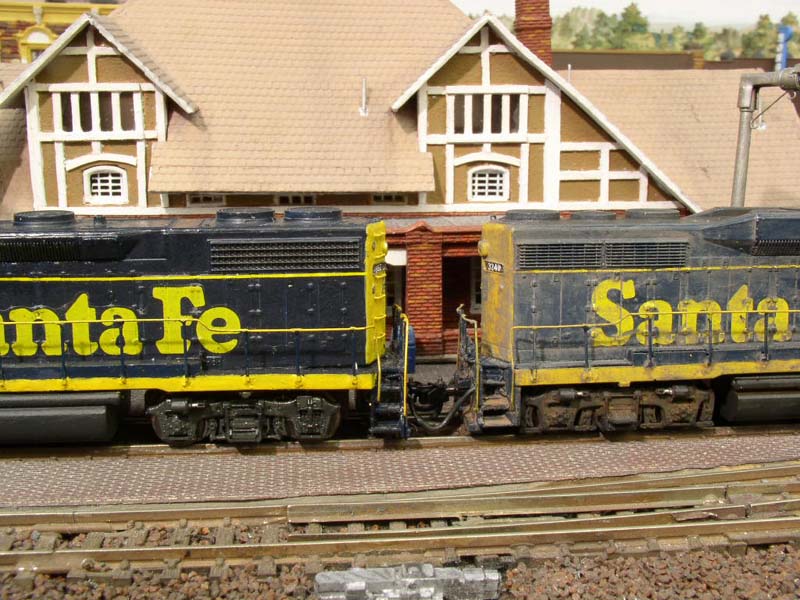

I went ahead and finished the first GP38  with my GP30 without swapping the trucks.
This is with putting 1/16" (.060) brass tube in the sill if the GP38, jumpers from those tubes to the contact plates (it would solder), then phosphor bronze strips jammed between the shell and frame halves with wire soldered to those.   I could have put the .060 tube in that but wanted to test the concept first.  The actual 'pins' are .010 spring wire bent in a tight "U" shape and inserted in the tubes, #30 black insulated stranded wire soldered to that.   So it's pretty easy to plug and unplug with a pair of tweezers.
But the real payoff is that wow, does this every work!    This pair now just has perfect pickup and performance.
