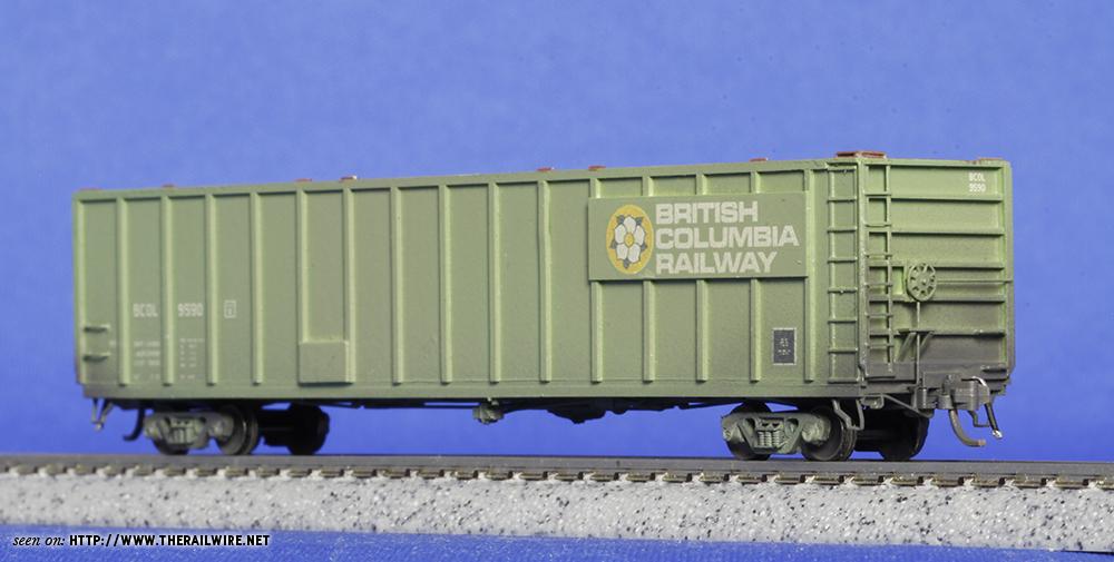

The third car is BCOL 9590 which was repainted for British Columbia Railway in 1976.  At the time of repainting the brake wheel was lowered, crossover hand holds were installed and shaker plates were added.  This left oblique view shows the 'B' end with lowered brake wheel:

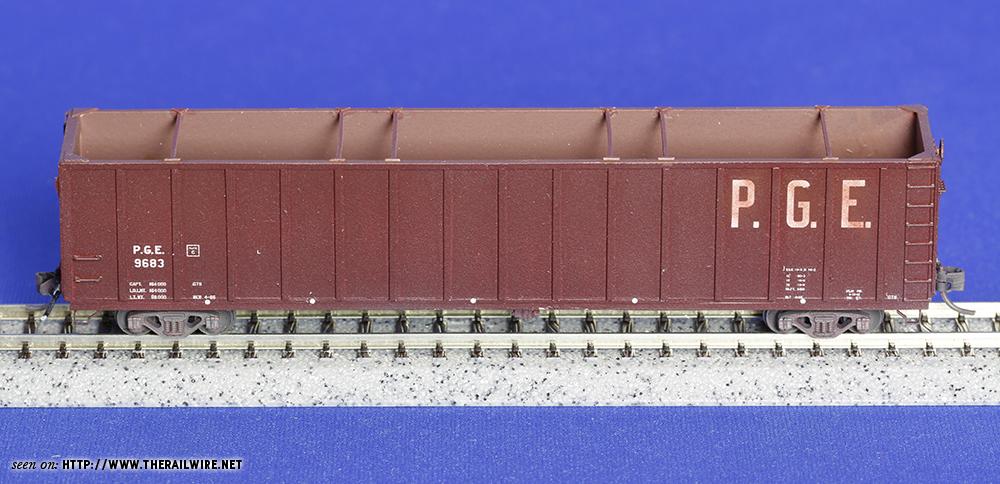

The fourth car is PGE 9683 which is identical to PGE 9507except for removal of the 'A' end ladder.  This right oblique view shows the 'A' end with dump door, and the ladder removed:

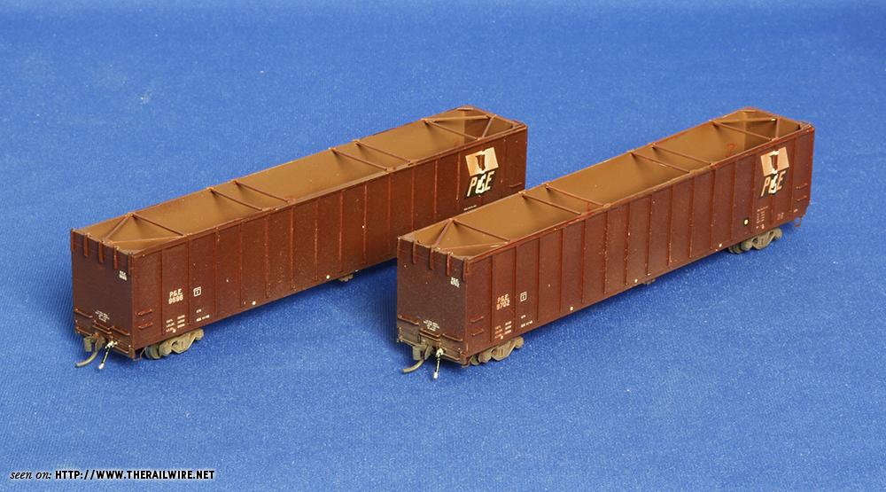

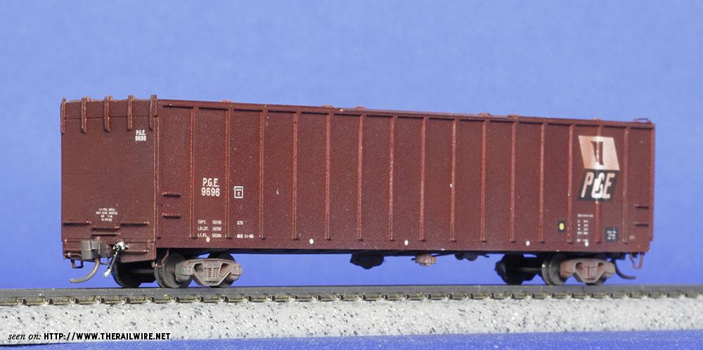

PGE 9696 is from the second series which had a different top chord arrangement, different internal bracing, grab irons in place of the side ladders, a low brake wheel, and a new design of door.  This left oblique view shows the 'A' end with the different door:
The final car of the six is PGE 9702 also from the second series.  Note the angle iron top chord with the centre twenty feet reinforced with a diagonal across the angle.  THis right oblique view shows the 'B' end with low brake wheel:

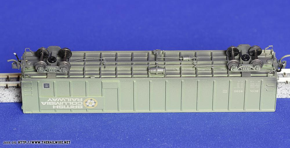

BCOL 9590 was upgraded with a more detailed underframe including floor stringers and full brake rigging in preparation for AP judging:
This top view of PGE 9683 shows the arrangement of the internal bracing on the first series cars:
And this top view of PGE 9702 shows the bracing arrangement for the second series, with diagonal braces at each end:
Final view of the four Series 1 cars:
And the two Series 2 cars:
Thank you to all those who have followed along, asked questions, or offered suggestions.
