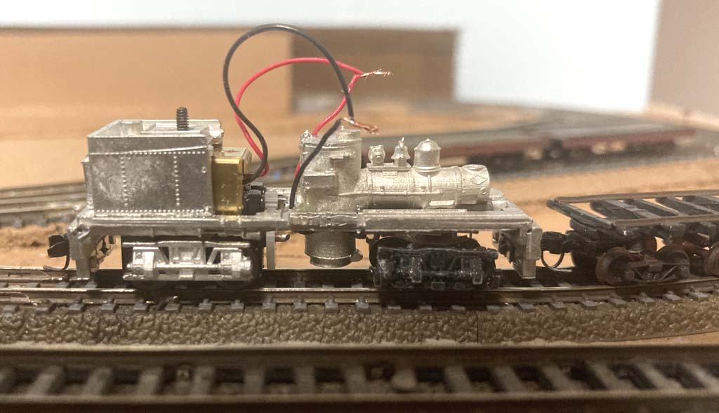

  • Posts: 3263
  • Respect: +2982
Re: New Nn3 power truck from Showcase Miniatures
« Reply #11 on: January 20, 2025, 10:01:05 AM »
Took some work, but I got the Rokuhan front truck with the Showcase sideframes on it, rigged up pickup contacts using a couple Kato 11-105 pickup springs bent around (insulated from cast frame with .005 styrene, goo'ed on) and routed the pickup wires under the frame and into the cab.
Put the boiler on the frame to hold the front springs down, and started testing it just with the wires twisted up.
Holy smokes, this is the best performing Nn3 chassis with that change you could ever want.   It simply does not stall now.  I'm going through Rokuhan #6 and Marklin curved turnouts with no hesitation at all.   It's surprisingly quiet.  I'm using the Blue Snail throttle with the 9v battery in it.
I am doing photos of this, even Showcase has asked for them.
Link:  http://www.randgust.com/Shapeways%20Nn3Shay%2010.jpg
Look on the front truck, you can see the pickup wipers reaching down from the frame to hit the ears on the Rokuhan truck.
So there's another design feature I'm trying to defeat, and that's the lack of even cosmetic drive shafts to the trucks from the cylinders.   I did that on my scratchbuilt 25-tonner, this is even smaller, so we'll see if I can beat this one.
Oh, and by the way - this is what Rokuhan sectional track looks like if you paint the ties and weather them, paint the rail, and paint the roadbed dirt color, as this is a logging railroad.  I painted each section before I put it down, a luxury on a tiny layout.
