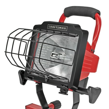

January 13, 2020, 08:51:42 PM »
My system is in the basement as well .. I had good luck with heating the printer by putting one of these a few feet away ..
