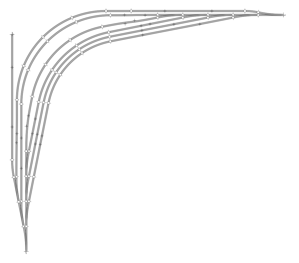

I took some time this weekend to lay out some cork for West Cressona.
It's not glued down yet because I wanted to "see it" to make sure I can life with the radii.
I can live with this, so it's time to get out the liquid nails.
It looks as though you have sufficient space, so why not make the yard track radii larger?
Before you start gluing down roadbed, maybe you'd want to temporarily set up a piece of track with the tightest radius and see how reliably cars will couple up on it.
  • Posts: 26151
  • Respect: +11679
Re: Conrail up in Coal Country
« Reply #196 on: November 11, 2019, 10:51:44 AM »
I've thought about the radii there quite a bit. Believe it or not the smallest one is 13". Which, while tight, isn't "zomg tight". I'm also not really expecting to use it as much of a yard track and it's biggest job is being the lead to the old engine servicing facility. In fact, looking back at the history of the plan, that track was a late addition.
There isn't as much space to unwind it as you'd think though if you look at the plan, especially from the other side.
I have thought about the coupling on a curve thing. On one hand, there's plenty of non-curved "apron" where hitches can be made. But, on the other hand it bums me out that using them wouldn't be following prototype practice where you set the one car in the end of the yard track and then couple up against that.
But I can live with it, especially given my heresy and widespread use of truck mounted couplers.

« Reply #200 on: November 11, 2019, 12:39:35 PM »
If you look at the "bigger picture", it appears as though there is room to move the yard throats out about foot at either end.
That would allow you to make the radii somewhat larger and/or add easements at each end of the curved yard tracks.

« Reply #201 on: November 11, 2019, 01:01:39 PM »
Maybe I missed it, but why not keep the reverse curve to a minimum?
  • Posts: 12384
  • Respect: +8723
« Reply #202 on: November 11, 2019, 01:23:22 PM »
Ed, you're fine.  There are sufficient tangent sections at the end of the yard tracks where the coupling/uncoupling can occur, even if that strays a little from the prototype.  If I understand correctly, this is not a classification yard, so not a ton of switching will occur here.  Plus, if the inner track is a 13" radius, that's wide compared to some of the curves that I've used on N scale layouts.  Heck, the Seaboard Central 2.0's minimum mainline radius was 12-3/8", and the branch was a 10" minimum radius.  Not to mention that moving the yard throats out a foot or so on each end just takes away that much more negative space from the layout.
There's no need to gut your plan.  Just build it and JFRTM (heh, JBIAFRTM).
  • Posts: 26151
  • Respect: +11679
« Reply #203 on: November 11, 2019, 01:54:31 PM »
I don't think I'm going to go that direction, but that IS an interesting take on it. Neat!
« Reply #209 on: November 12, 2019, 05:48:04 PM »
Yeah there's an operational issue of dealing with a curved yard, but I gotta say in the "simulated" yard, loaded with hoppers– the look is really cool.
