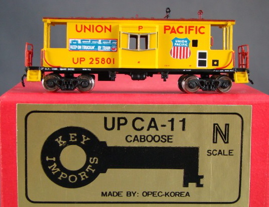

I had a couple of OMI's CA-11's...the last caboose built specifically for the U.P. (a bay window design) and it captured the overall look of the prototype, but was pretty crude.  Since they were out of my era, I sold 'em and I never took a photo of 'em.
You mean Key, right?
-Mark
Thanks Mark for this correction!  No, I couldn't remember the manufacturer since it's been about eight years since I sold both of my CA-11's!  I edited my post and gave you credit.  :D

I got my Key brass UP caboose at a local train show a couple of years ago.  It is not new in the box like Mark's since it gets frequent use.  Those window bug screens on the side set it off!
