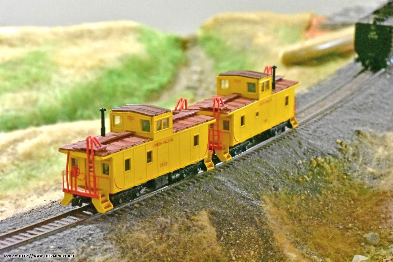

Next are the Intermountain (Centralia Car Shops/Golden West Models kit) models of U.P.'s first and second riveted steel-bodied cabooses, the CA-3 and the CA-4, which for all intents and purposes are identical save for a steel brace under the end roof overhang that is reversed on the CA-5.  The original Centralia Car Shops RTR versions had new, highly detailed plastic roller bearing outside swing-hanger trucks in place of the Golden West Models kit's, which are very poor, flat models that not only looked very bad, but also ran very bad.  This was good, even though the new trucks were fragile and often didn't roll very well.  The latest offerings by Intermountain are from the same Golden West Models kit, but they've gotten rid of the excellently detailed correct trucks (for post 1952 CA-3's and CA-4's), substituting leaf-spring steel versions that never were put under these cabooses...with big, ugly bright brass washers between the truck and the caboose's bolsters to get the model to the correct height.  They've also added a grossly thick and horribly detailed cupola running board, which was on the first CA-3's when introduced in 1942, but within months was cut off because it was exceedingly dangerous.  It may have lasted into 1943 on some CA-3's.  This detail applies to only CA-3's painted in the early Mineral Red (reddish brown) color with white lettering.  No Armour Yellow steel cabooses had it, and no CA-4's ever had it either, even when painted Mineral Red/white. Unfortunately, Intermountain is applying this detail to ALL of its U.P. CA-3's and CA-4's.  Luckily, it's easy to remove, as is the whole cupola roof.
Intermountain's CA-3's and CA-4's have sporadic build quality, with lots of things glued on crookedly or sloppily. With their new inaccurate trucks and funky cupola running board, their accuracy has been severely diminished.  The running board details and the curved upper grabs of the end-ladders have always been grossly rendered.  My advice is to attempt to find the older model, with the outside swing-hanger trucks and no cupola running board.  As has been posted, you can get 3D printed outside swing-hanger trucks from Keystone Models, but they have roller bearings...which are incorrect for any U.P. steel caboose before 1964. CORRECTION!  Keystone Models offers both roller bearing outside swing-hanger trucks with or without the truck-mounted alternator for post 1975 CA-3's and CA-4's, AND friction bearing outside swing-hanger trucks.  So, you can pick your caboose year even more specifically!! Thanks Mike! :D
Photo (4) - Intermountain Centralia Car Shops older CA-3 model w/proper solid bearing outside swing-hanger truck, no cupola running board and better assembly quality...GET THIS GENERATION:
Photo (5) - Intermountain Centralia Car Shops newer Gen CA-4 model w/incorrect roller bearing trucks, incorrect cupola running board, bright shiny brass spacers between trucks and bolsters, and bad build quality...AVOID THIS GENERATION:
If you can't find what you want as far as lettering is concerned on the Intermountain CA-3/CA-4, the lettering is easily removed with isopropyl alcohol and a Q-tip, and you can re-letter them with the excellent decal sheets from Microscale Inc.  I've done that to several Intermountain CA's for friends. To get rid of the sheen that results from rubbing the wet Q-tip on the old lettering, mask the windows and spray with Dullcote.
Photo (6) - Newest Gen IMR/CCS CA-3/CA-4 cabooses with stock lettering removed, removed cupola running board and repainted cupola roof, with Panamint "Q" trucks, FVM 33" narrow tread semi scale wheelsets and reworked center sill:
Photo (7) - Same cabooses with new lettering sitting on the Park City Yard Lead, waiting to go south to Nate Goodman's caboose track on his home layout:

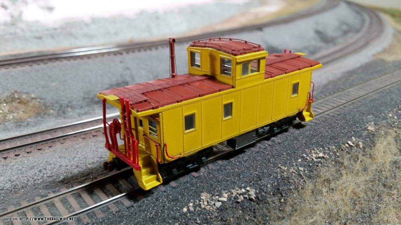

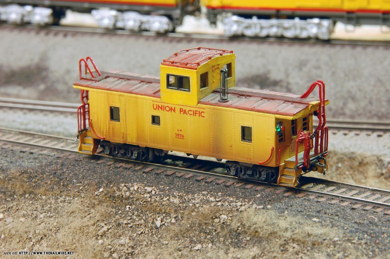

U.P. Cabooses in N-scale Part 2:
Now I'm going to get into the brass U.P. cabooses a little, then about how to get yourself the most desirable U.P. caboose... :)
All of the rest of U.P's steel cabooses have been manufactured in brass in varying qualities and detail levels from OMI and Hallmark.  OMI (Overland Models) had at least two versions, the early versions and the more highly detailed later versions.  The early versions weren't painted, but the quality and accuracy of the second and third versions is really excellent!  However, they're hard to find, especially the early paint job versions with running boards and no Pool Service modifications. The early OMI U.P. CA cabooses with the cast-on running boards actually look pretty good when the cracks are filled, details straightened and they're properly painted.
Photo (1) - Early OMI CA-4 in Mineral Red (with incorrect inside-swing-hanger trucks which came with the model):
Photo (2) - Early OMI CA-5 in early Pool Assignment regalia:
Photo (3) - Early OMI CA-4 Caboose in Armour Yellow with Added Smokejack Braces & Marker Lamps:

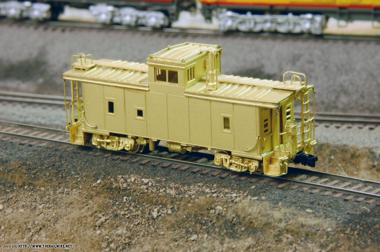

Hallmark had two models that were of poor quality and called them "U.P. Welded Caboose" and "U.P. Riveted Caboose"...the riveted caboose was of an imaginary prototype never seen in this world, but the welded caboose represented (although pretty badly) U.P. CA-8, CA-9 and (with a little help) CA-10 cabooses.  They were all unpainted, and with a lot of work, the welded caboose could represent a highly accurate model of the CA-8, CA-9 and CA-10 cabooses since the carbody was pretty good, and the brass investment cast grossly oversized and inaccurate add-on details could be easily removed with a good resistance soldering station, and replaced.
Photo (4) - Hallmark "U.P. Welded Caboose" straight out of the box...really distorted but with some good dimensions and some good detail parts:

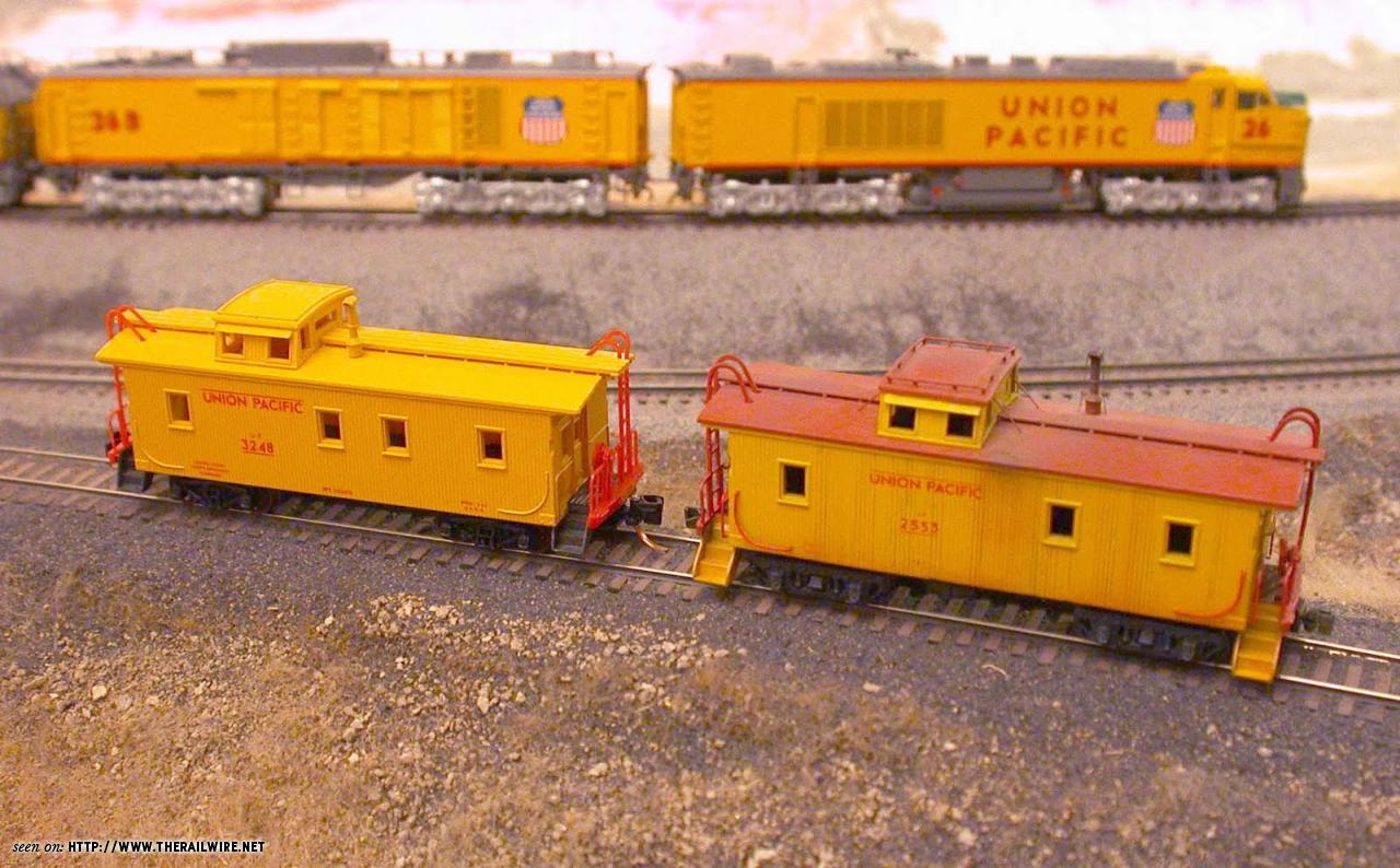

Now, we come to the one caboose that U.P. had more of than any other caboose...and it lasted longer than any other caboose on the system...the wooden, steel-framed CA-1, of which U.P. had 380 of them being built from 1914 through 1924.  Unfortunately, no brass or plastic RTR models of this caboose have ever been made in N-scale.  The CA-1 was significantly different in appearance than the Kadee/MTL "wooden" caboose, which is almost always said to be "a CA-1"...but, it is not.  The most obvious visual differences between the Kadee/MTL "wooden" caboose and the prototype U.P. CA-1 is First, the cupola location, which on the CA-1 is much more centered.  Second, the CA-1 has three windows on the sides rather than four.  End windows differ between both the CA and the CA-1, but the most common end window arrangement is two windows as opposed to the CA's one window. Third, the smokejack is on the opposite side of the car.  Fourth, the roof is also a few inches longer, and Fifth, the steel framing cross-braces are plainly visible on the lower sides of the CA-1, as well as a much deeper steel center-beam.  CA-1's were built with steel frames to withstand the rigors of the new, bigger and more powerful U.P. motive power. The last U.P. CA-1 was retired in November, 1971 and is on display at the Utah State Railroad Museum at the Ogden Union Station, unfortunately in an increasingly run-down condition.
Photo (6) - Stock MTL "wooden" caboose erroneously called a CA-1 vs my kitbashed pilot model properly proportioned as an actual U.P. CA-1:
So, it's pretty visually obvious that the MTL "wooden" caboose isn't a CA-1, or even a good "stand-in".
To get yourself a proper U.P. CA-1, you're going to have to scratch-build it or kitbash it.  I prefer kitbashing, starting with two Kadee/MTL "wooden" cabooses and using Evergreen Styrene shapes and siding sheet, MTL couplers, Panamint Models (at Shapeways) "Q" trucks (T58p x8 N offset passenger truck, Caboose, Overton), Precision Scale brass investment cast underbody brake details, GMM's Heavyweight Passenger Car Detail fret, and FVM semi-scale narrow lo-pro 33" wheelsets.  Having a vertical mill also assists me to get the MTL metal frame modifications just right.  I fabricate the end platform railings and ladders, but the stock MTL items can be used in a pinch.  My own brass marker lamps and MV red/green lenses and .003" 6-0 Suture Silk Smokejack Bracing Wires top the model off. Scalecoat II enamel paints, and Microscale Inc. decal sheets and a bit of weathering finish the project.
Photo (7) - My First Kitbashed pilot model from two MTL "wooden" CA cabooses of a U.P. CA-1:
Although it looks a lot like a common U.P. CA-1, there were some things about my pilot model that weren't correct, or what I wanted.  The window arrangement on the sides and ends is a bit flexible prototypically, as the various shops that made this caboose took liberties with how many windows were on the ends...ranging the full gamut from none, to one, to two. I chose two end windows because it was different than the MTL model, and I wanted to see if I could make an okay window out of Styrene sheet.  The number of windows on the sides of the car were almost always three, but I didn't move the cupola-end side windows more towards the center of the car in this build (I got lazy), so I wanted to do that in all future kitbashes.  Functionally, doing this would also make the end-seams of the new Evergreen siding pieces in more easy-to-align positions.  Also, I didn't lengthen the roof extensions over the end platforms as on actual CA-1's, and the ladders on the ends, although okay, are not entirely correct...the real CA-1 having a distinctive kink in the ladder directly off of the top of the railing it's bolted to in order to compensate for the added roof length.  I also wanted my CA-1 to have vertical brake wheels instead of the more modern stands that are on the MTL end railings...although some CA-1's received the later brake stands, some only got them on one end of the car, and kept the older, vertical wheel on the other end, like the CA-1 at the Utah State Railroad Museum at the Ogden Union Station.  Also, when looked at from the side, none of the steel frame ends or the deeper center sill are there on this first kitbash, and the underbody brake equipment is bare minimum too.
