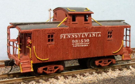

Ok, while my engine is in progress I figured it was time to start a caboose.
The easy thing to do would be to use the ubiquitous Bachmann bobber. Except... that car has so many issues it's got a subscription: too many windows, chunky molding, etc....
So, what to do to create a nice MPA bobber?
Well, originally I was going to take the shapeways bobber floors, build a new body on top of them, and use some shapeways MTL caboose cupola replacements.
But then... I realized that doing the body would be a challenge, and I might want to try just shortening an MTL wooden caboose to fit the bobber frame.
So that's what I'm doing!
Here's the progress.
Is it going to be a spot on accurate model of MA&PA 2006?
Nope!
Am I going to be able to live with that?
You bet.

Way better than a Bachmann bobber (and way easier than bashing one): an Arnold bobber:
http://www.spookshow.net/freight/arnoldbobber.html
That's my pic.  :D
Anyway, some info on these here: https://www.therailwire.net/forum/index.php?topic=44845.0
Possibly an Arnold Rapido bobber with a Panamint underframe?

I don't know, that Arnold car doesn't look perfect either.
But it may be a backup if this plan doesn't pan out for some reason.
That being said, if this DOES plan out, anyone with some resin casting chops want to borrow the shortened body for a master? I'd like a few more myself and I'm sure some other folks (like @Mark5 ) might enjoy them as well. With a ready to go body, it's should be a quick assembly job.

I think you're going to have a hell of a time hiding that seam in the siding.  I suggest just scratchbuilding the body with some Evergreen freight car siding, basic styrene parts, and some Tichy or Grandt Line windows and doors.  Much better end result, and you can build a much closer facsimile.

I don't think I'll have any problem with it. Obviously there's lots of fitting to do in the image you see above, but the wood siding can make this VERY forgiving.
If it doesn't work I'll be onto the siding option, but I'm trying to avoid having to deal with the window trim or the roof trim.

There's a few PRR style points on that, but what would really kick would be if you could find one of the old Quality Craft PRR caboose kits, as there was enough material in there to build it on top of a good frame.  But it sounds like you've got a good plan.   One thing I really notice is those four-pane windows, that is a signature item - and the QC kit had those as castings:  http://www.spookshow.net/freight/gloorn6b2.jpg

I do like your approach.  I think if you use a steel square and some sandpaper to really true up those cuts, you should be able to hide the seam right down in a joint between the siding so it won't show without too much trouble.
The Quality Craft N6 kits are terrific.  I still have one I built years ago.   They are much MUCH easier to build than the brass Quality Craft N5c kits.  I'd highly recommend going that way if you find one.  And if you put it on the new Shapeways frame with nice wheelsets, it would be killer.
