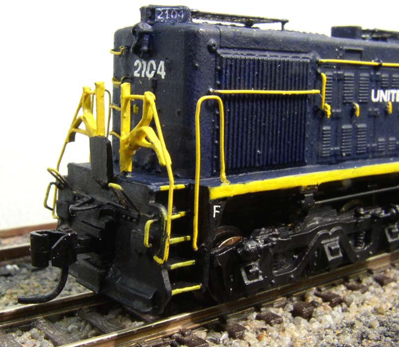

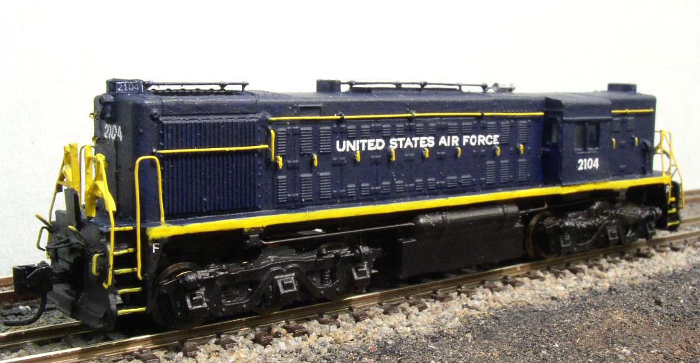

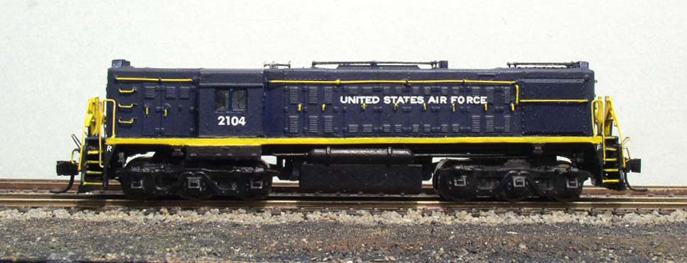

This has been an interesting project - I was commissioned to build the USAF MRS1 2104 (Vandenburg, now at the Campo railroad museum).   The shell was originally a Shapeways design that didn't really make it in FUD, was passed around and reprinted by another service and sent to me....and this was just amazing.  This is the best RP printed shell I've ever seen.   No sanding, no prepping, no nothing - other than a whole lot of detail and paint work on handrails, wire details, and getting the entire thing to work over a Kato RSC2 chassis that I got last year down at Altoona.   For those of you saying that an Atlas RSD4/5 would work better, I strongly disagree, as the performance of this chassis was just outstanding, and very little material had to be removed from the cab frame area to do it.
Yes, the door handles are individual bits of .010 wire, etched walks added, .010 wire handrails, and fully soldered end rails with rectangular .010x.020 stock.   Micro-scale decals, and computer-printed number boards.
Like most RP designs, it was done without much consideration for how it was ever going to work on a mechanism or a finished model, so if anybody else is trying this I've got two pages of detailed notes on all the dimensional modifications I had to make on the shell to make this work.
