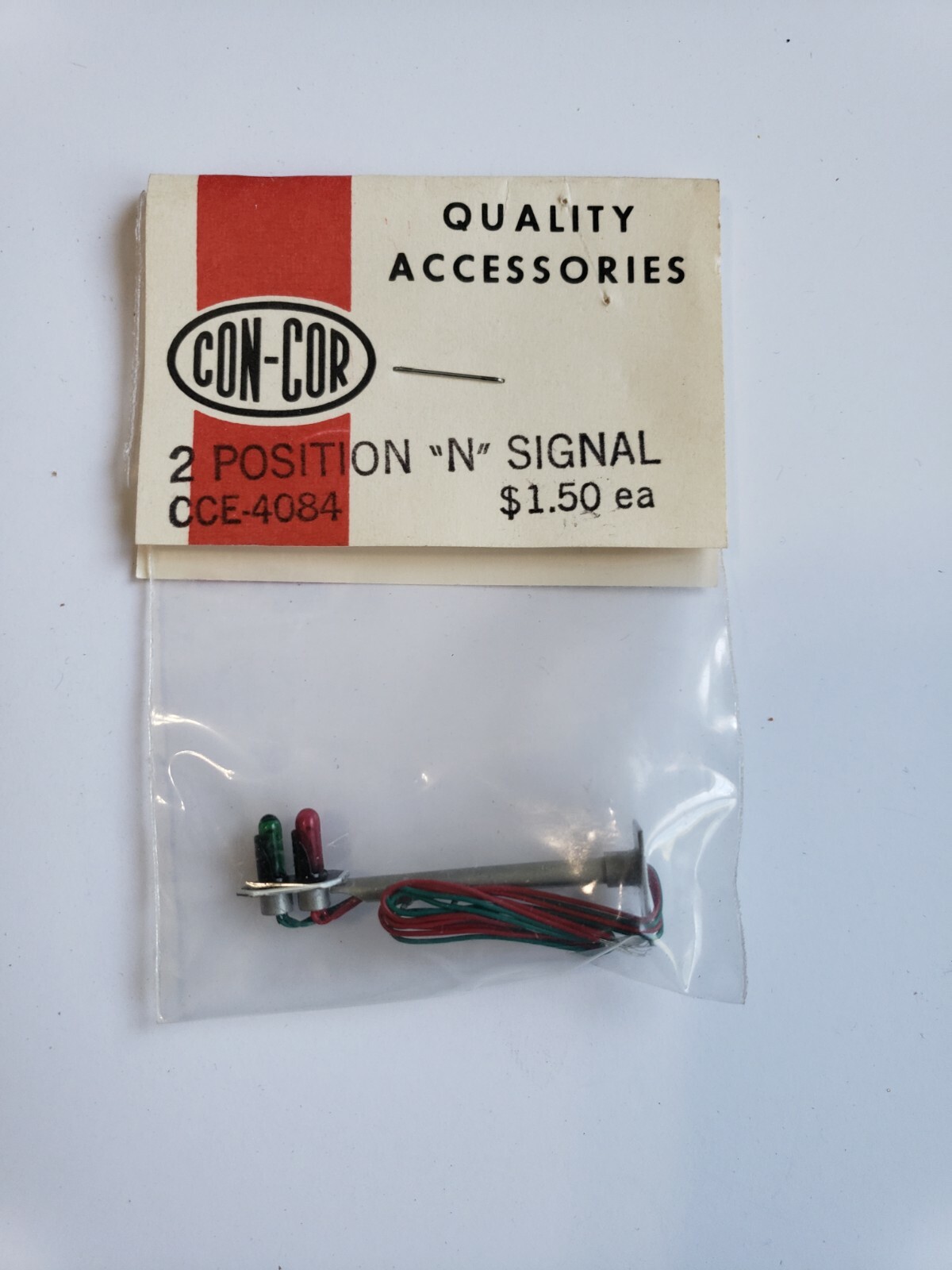

Better scan ebay for a good deal on Round Tuits.
While you're scanning eBay, be on the lookout for these vintage trackside widgets:
