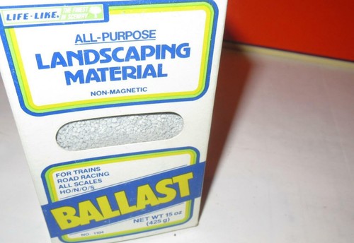

Now I can ... maybe start some ballasting.
Are you planning to use "vintage" materials?

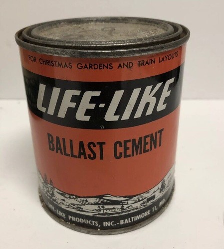

Well, I have a bag of Lichen and some John's Ballast...  anyone remember that stuff?

I still have a can of that same ballast cement and a couple of boxes of Life-Like red and gray rock from when my brother had his HO layout in the sixties. A box of lichen too that's like rock.
