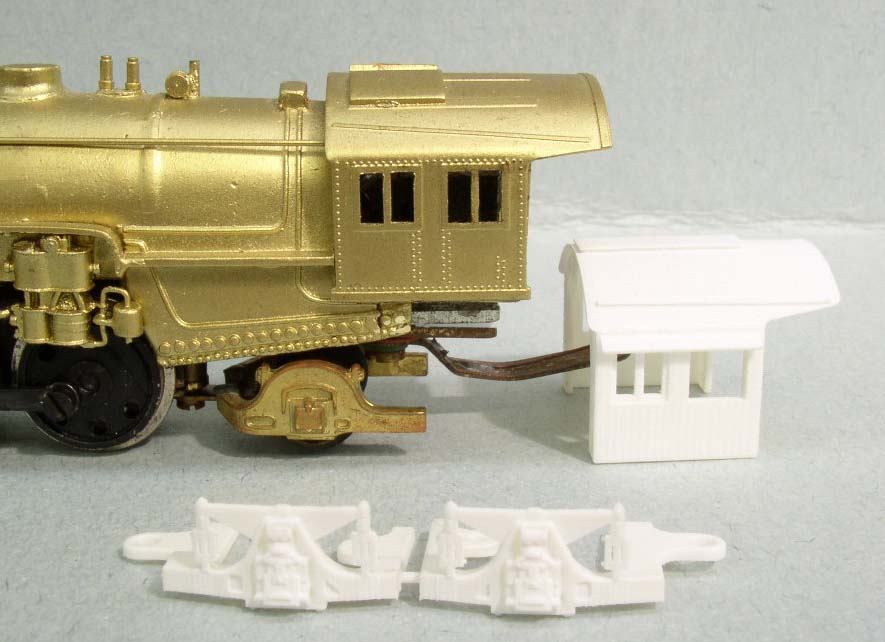

2)  I got in the Shapeways ATSF cab and Hodges trailing truck.  The cab is about a foot shorter, and you can see that getting the windows properly proportioned make a huge difference.   It's like the eyes in a painting.   The old cab will come off a lot easier than I ever imagined, just haven't done it yet.

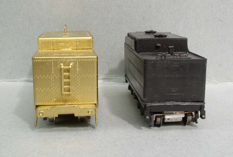

3)   Now, here's the next major change.   I just got in the ATSFmodels tender today, it's RP printed, and it's a honey.   As you can see, unlike the stock tender, it will fit under the cab roof even after it has been lowered, so I can snuggle the tender up as close as practical.

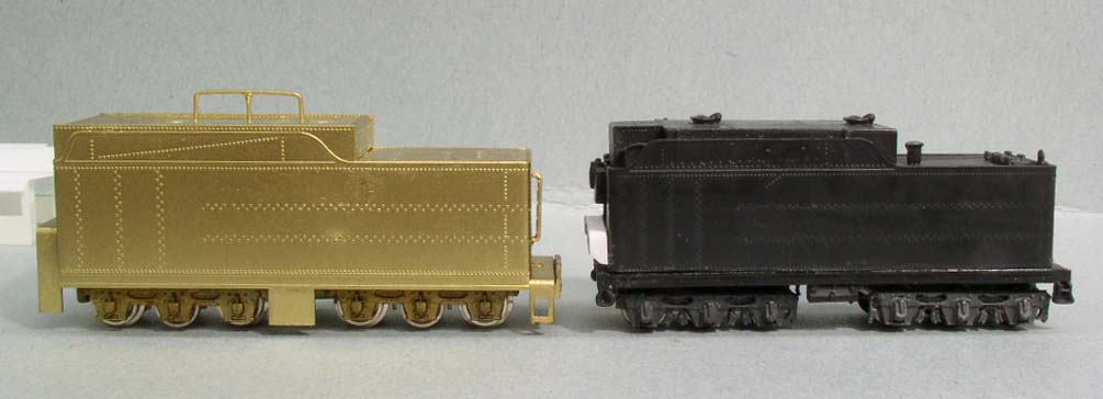

More on that tender, here's the comparison between the stock brass tender and the kit one.   You can see how the oil bunker should look, tucked in the 12K tender.

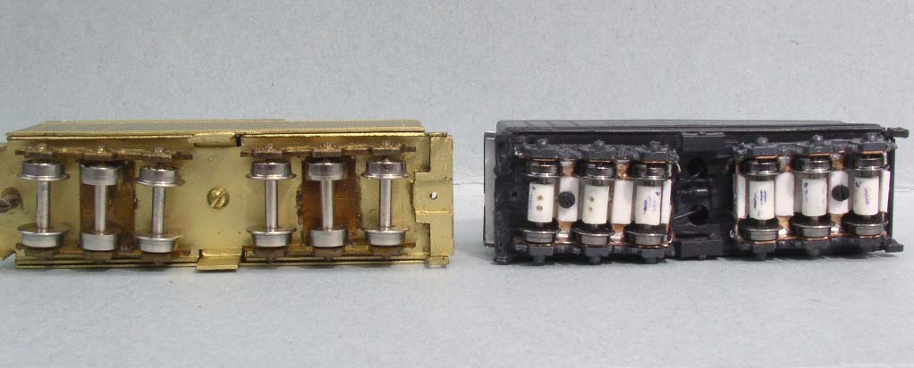

And finally, what really got me here, was solving the well-known pickup issues on this model, I really wanted a 12x12, end-axle pickup tender, and everything else I researched had wheels and trucks that were way off.  Man, he's got this one beat, glad I did it.

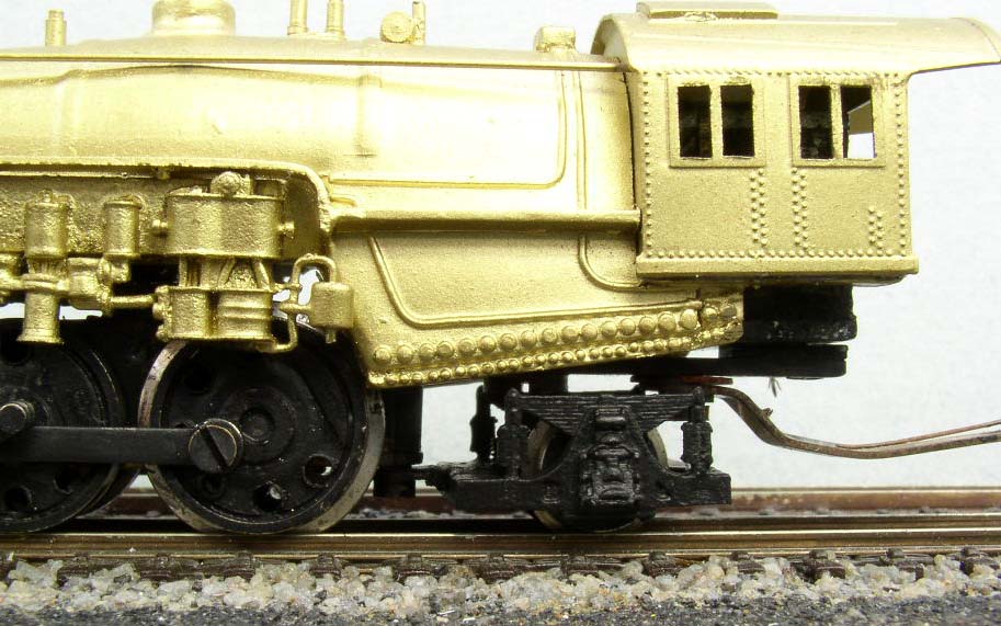

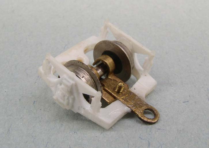

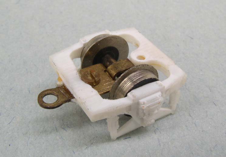

Well, here's the rebuild of the trailing truck to a Hodges with the Shapeways sideframes.
The stock Jamco wheels are plastic, and the Delta trailing truck casting was kind of 'meh' and wrong for the 3415.  The Shapeways one is an HO concept reprinted to N, and it has no particular ability to connect to anything, and it was end-bearing design.  I looked at a bunch of wheels to replace the Jamco axle with (as it had no axle ends), and I thought I'd be able to use a 42" Kato wheelset.  But...holy crap, that trailing truck wheel was big.  I checked the clearance diagram, and there it was - 51".  Wow.  A 51" trailing truck wheel.  I really had to dig in the junk drawer and found an old Bachmann 4-8-4 trailing truck wheel that was that size, and the axle length was OK with a little more drilling in the sideframes.   It took some doing to adapt the trailing truck drawbar to the printed sideframes, but it worked and rolls easily.
A smaller wheel resulted in the truck running 'low'.  I'm undecided about how the wheel looks, but if it as buried inside the sideframe as I think, I'm not turning those flanges unless they create a problem.   I'd rather have that nice heavy metal wheelset there that's free-running.  We'll paint that up and see what that looks like.

Are you saying that the prototype loco uses 51" diameter wheels in the trailing truck?
What diameter do the wheels you used scale to?
Maybe you could use standard low-profile Kato 41" diesel loco wheels? Or if those are too small, Kato GG1 wheels are even larger, but not available separately - you have to buy the entire truck assembly. Or maybe ACS-64 wheelsets?  Those could be larger than 41".
But all those have plastic axles, so they would need axle-end bearings.

Yep, 51" wheels.  No kidding, right on the loco drawing, and those 79" Boxpox drivers.  I have Kato wheels, tried them, too small though that was my first choice.   The Jamco set probably looked better, but with plastic wheels in the lightweight frame, the whole trailing truck assembly was so light it derailed with little provocation after I unsoldered the brass sideframes.
When I'm doing a project, if there's a conflict between what works well and what looks perfect in enlarged photos, works well usually wins.
But as you can see, I kept the screw assembly intact to still work with a different wheelset, just in case.   I've turned wheels before, some easier than others though, and it's risk v. reward.
Update:  Painted and installed, it's flat, it fits, and you really can't see the flanges, so unless it gives me grief, it's good.   That's a nice print.
I think the wheel is the least of my problems, as what's glaringly apparent is the open void under the truck where the rear of the frame should be.  I need some kind of visual barrier in there or something, either under the cab or mounted on the truck itself.  I'm planning on redoing the entire drawbar assembly anyway, so we'll see what works.  To me that looks pretty awful as it's a solid mass of metal above the truck in the photos, you can see the frame right between the wheels of the trailing truck.
