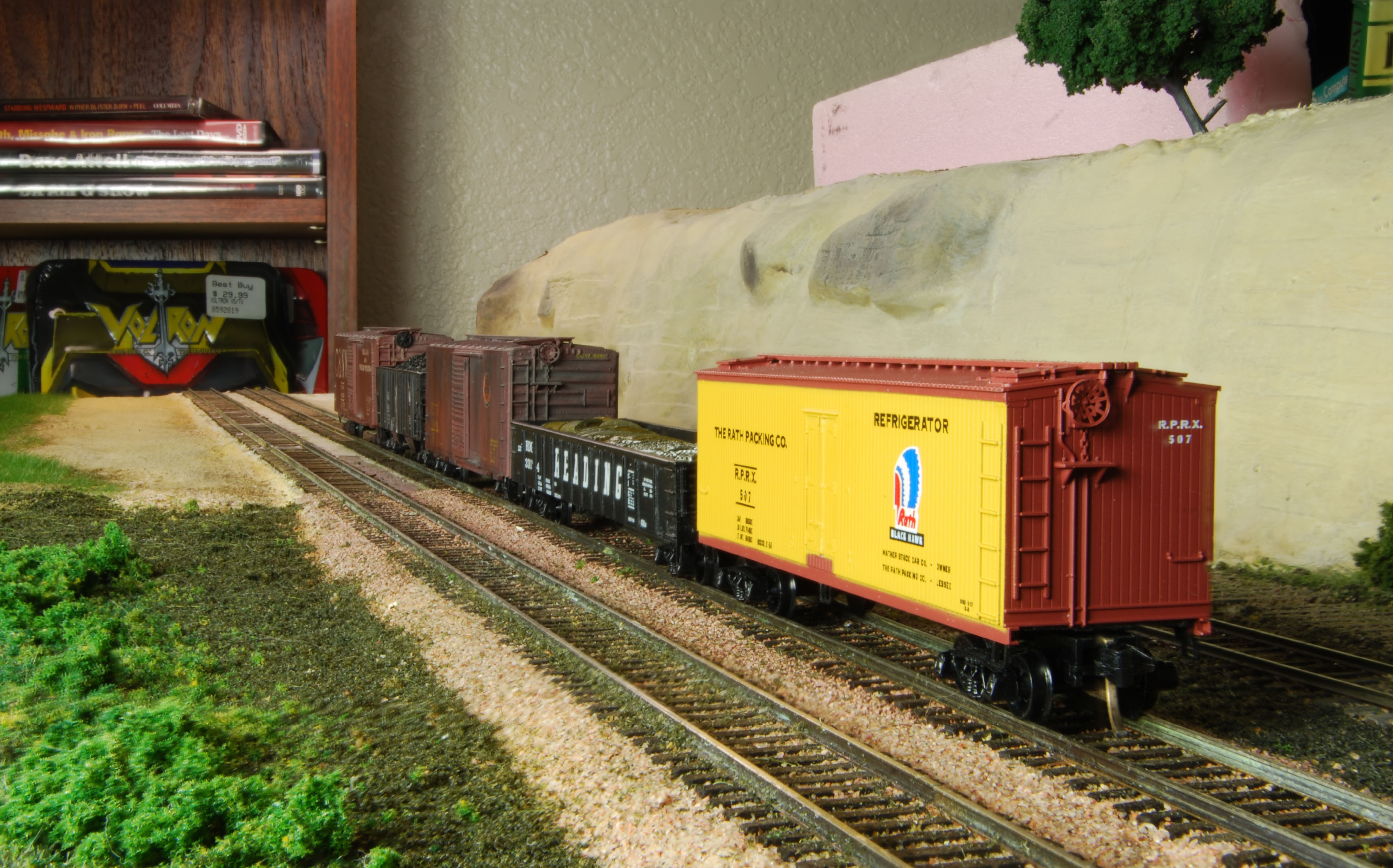

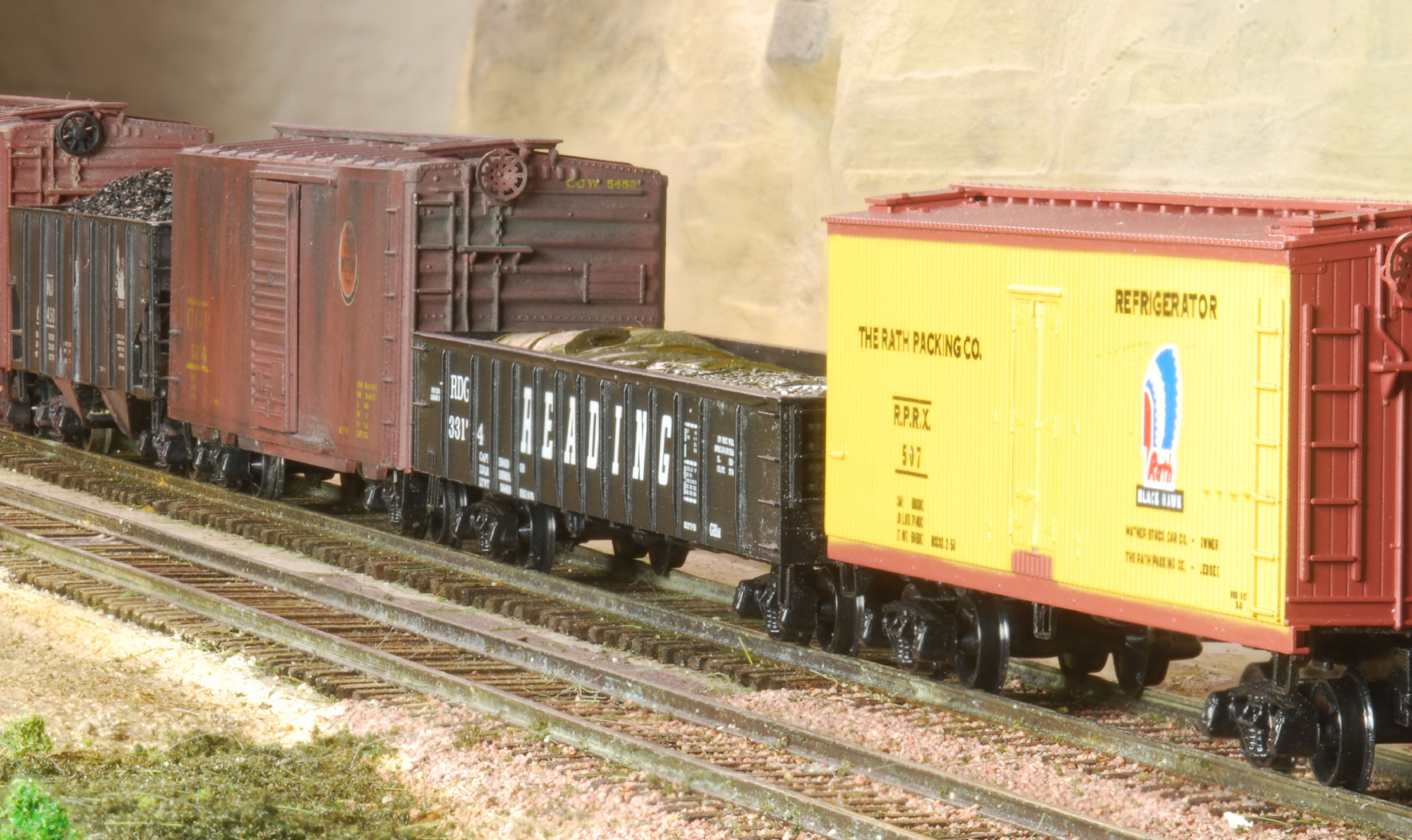

Here's a comparison shot with a Nikon D40X.
35mm
55mm
105mm Macro
35mm
55mm
105mm Macro

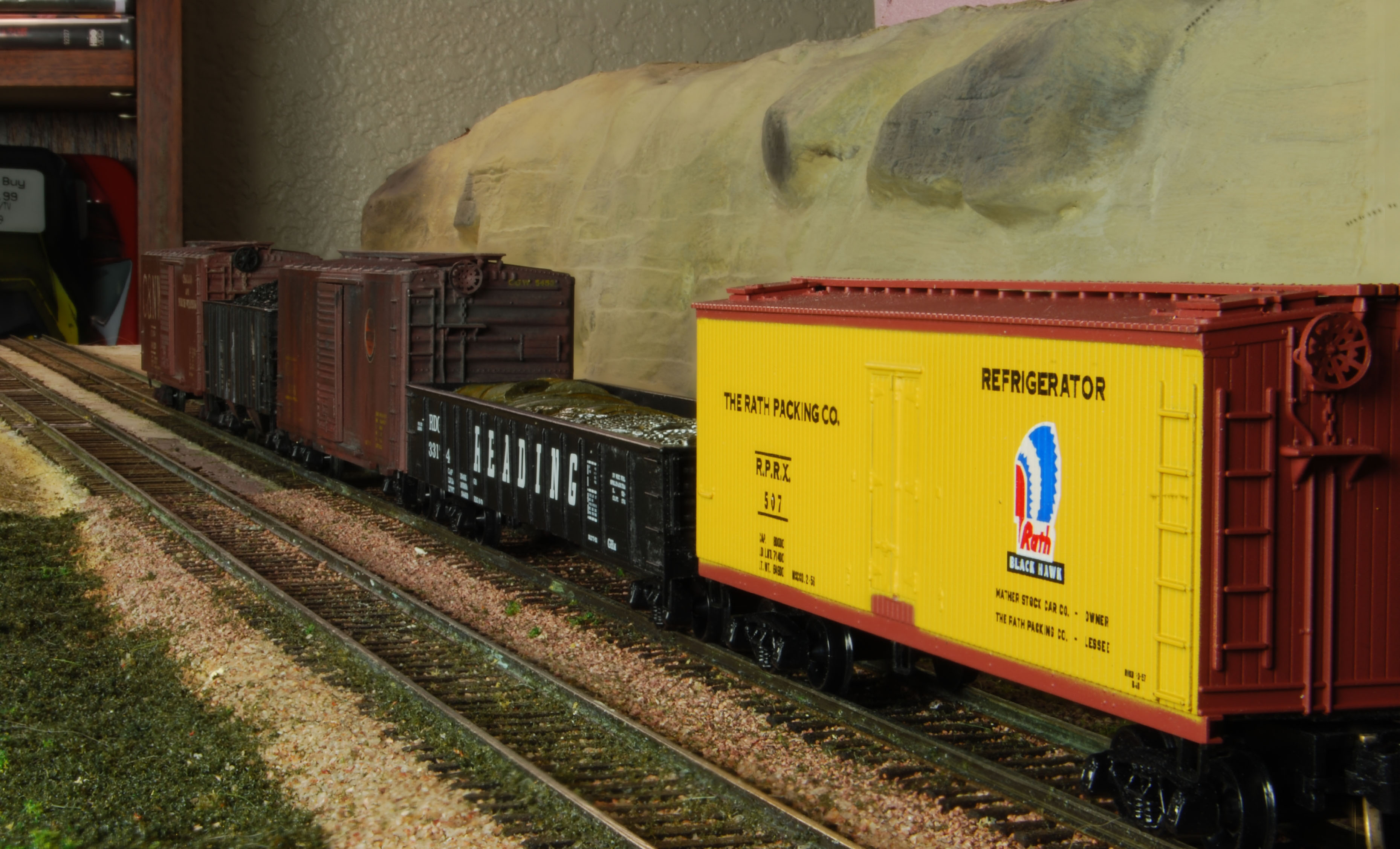

Just for kicks I cropped Jason's wide angle (35mm) photo to look the same as hsi telephoto (105mm macro) photo. Telephoto lens simply has a narrower angle of view.
This is the 35mm photo cropped to what the 105mm macro lens sees.
