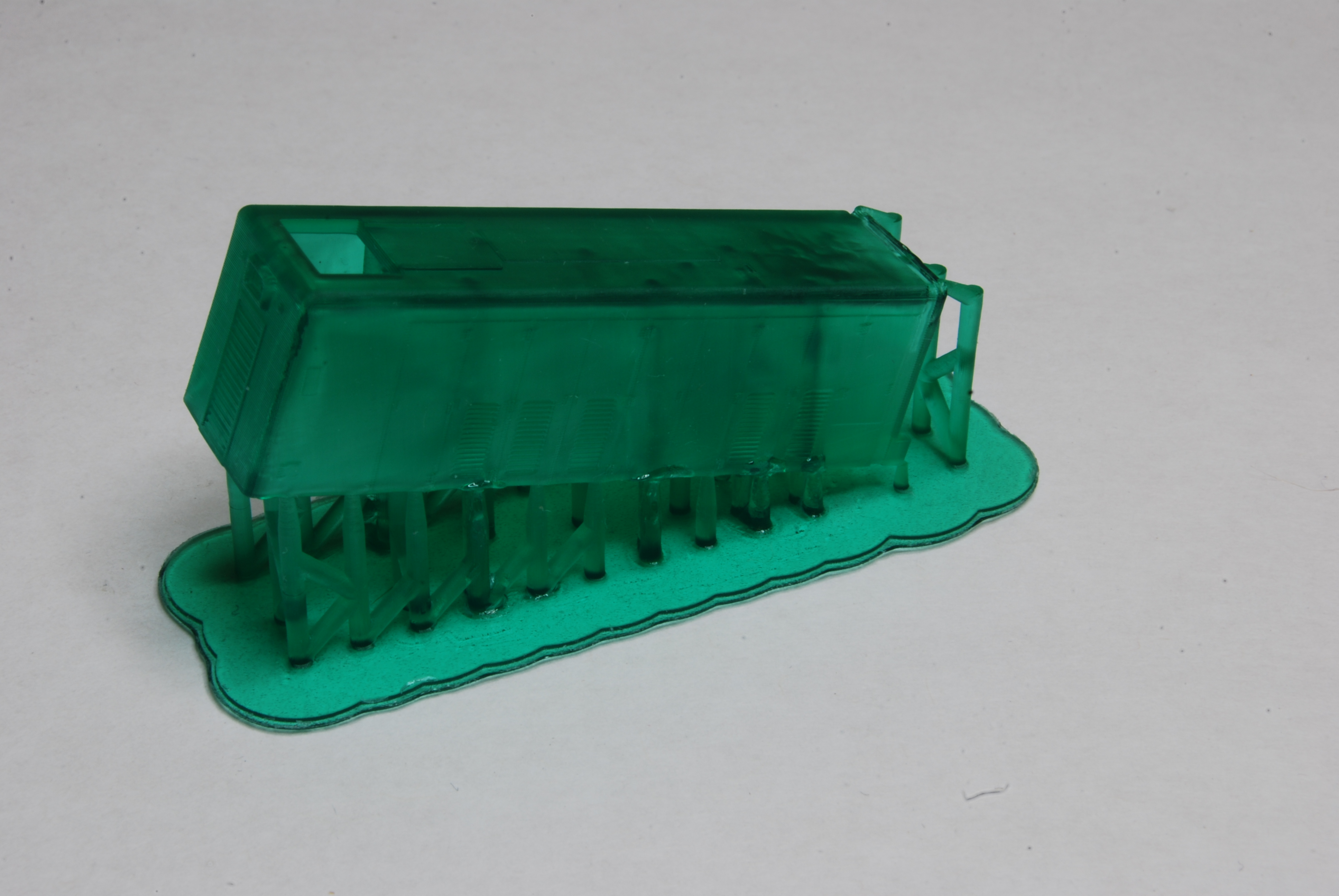

I had some time tonight to finally give the Dry Bulk Trailer a go.  With the complex underside, I had to spend about 40 minutes placing supports.  And once I finished placing the last support, I clicked to orbit around and review everything, and Netfabb crashed.   :x :facepalm:
Nonetheless, I powered through it all again and ran it to the printer.
https://i.imgur.com/cyzRbWx.jpg
I went through the second round supports a lot quicker, and knew ahead of time I was risking too-few supports, so I didn't have high expectations yet.  Surprisingly, I got a failed success.  Failure, in that some of the supports did fail and part of the tank scrunched up, but successful in that the hose detail was not the reason for failure, and the hose detail is all there!
https://i.imgur.com/3LVoXii.jpg
I have version 2 with improved supports running now.  If it turns out to be completely successful, well, then CGNScale, which has been dormant for about 5-6 years will be going back in business!  8)
