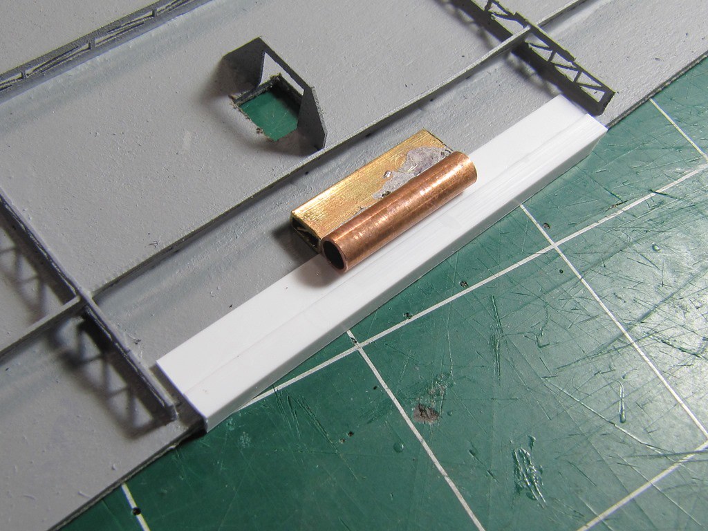

And so on to final assembly and the last big risk: how to removably attach the 3 roof segments so they can be quickly opened in an ops session.  I also want attaching the roofs to pass power to interior ceiling lighting, but this may have to be sacrificed if I can't make it reliable.  The biggest issue - as Tim pointed out a few weeks ago - is the roofs are big, flat pieces subject to bending and warping.  Luckily they are also relatively flimsy being 40 thou thick (before sand paper "asphalt" cover).  The mechanisms need to "pull" the roof edges down flush with the wall tops.
Of the few ideas I came up with the one I am running with is to use copper tubing glued parallel to the roof edges which "snap" into brass channels glued to the inside top edges of the long walls forming a series of 20 latches.
Alignment is of course important so gluing jigs were made up.
Bench testing under finger pressure is promising so far.
I hope to assemble the large running shop section this weekend and, if that one works, the heavy shop and stores buildings next week.

Thank you! One of the reasons I set aside my Kentucky Electric Steel industrial challenge was the issue of how to attach the roof to the walls to be both structurally strong and removable. How did you attached the metal tubing to the styrene? I mean, what type of glue did you use?

Mark, did you consider magnets for the roof attachment?  I have been considering attachment techniques, and am thinking that mechanical snaps might corrode over time enough to substantially increase the force needed for removal.  Magnets would tend to keep the same force.

Now there's a good idea!  If the snaps don't work I will try those as that should work for sure.  Thanks!
I do like the planar alignment the cylindrical tube should give when engaged in the channel but it does require adequate force.  The magnets would be a bunch friendlier alignment wise and not require adequate "hoop strength" in the assembled walls.  We shall see soon I hope. I will let the forum know how it works out.

A caution about magnets.  If you use them, keep a small gap between, 1/16-1/8", the magnet and the ferrous attractant you use. This will provide an effortless removal. Otherwise if you let them touch, you will find the roof twisting with each release, and if you don't remove the roof in one fell swoop, some could become reattached as you work your way along the roof.
Yes I have been working with them a lot lately on some other new projects.
