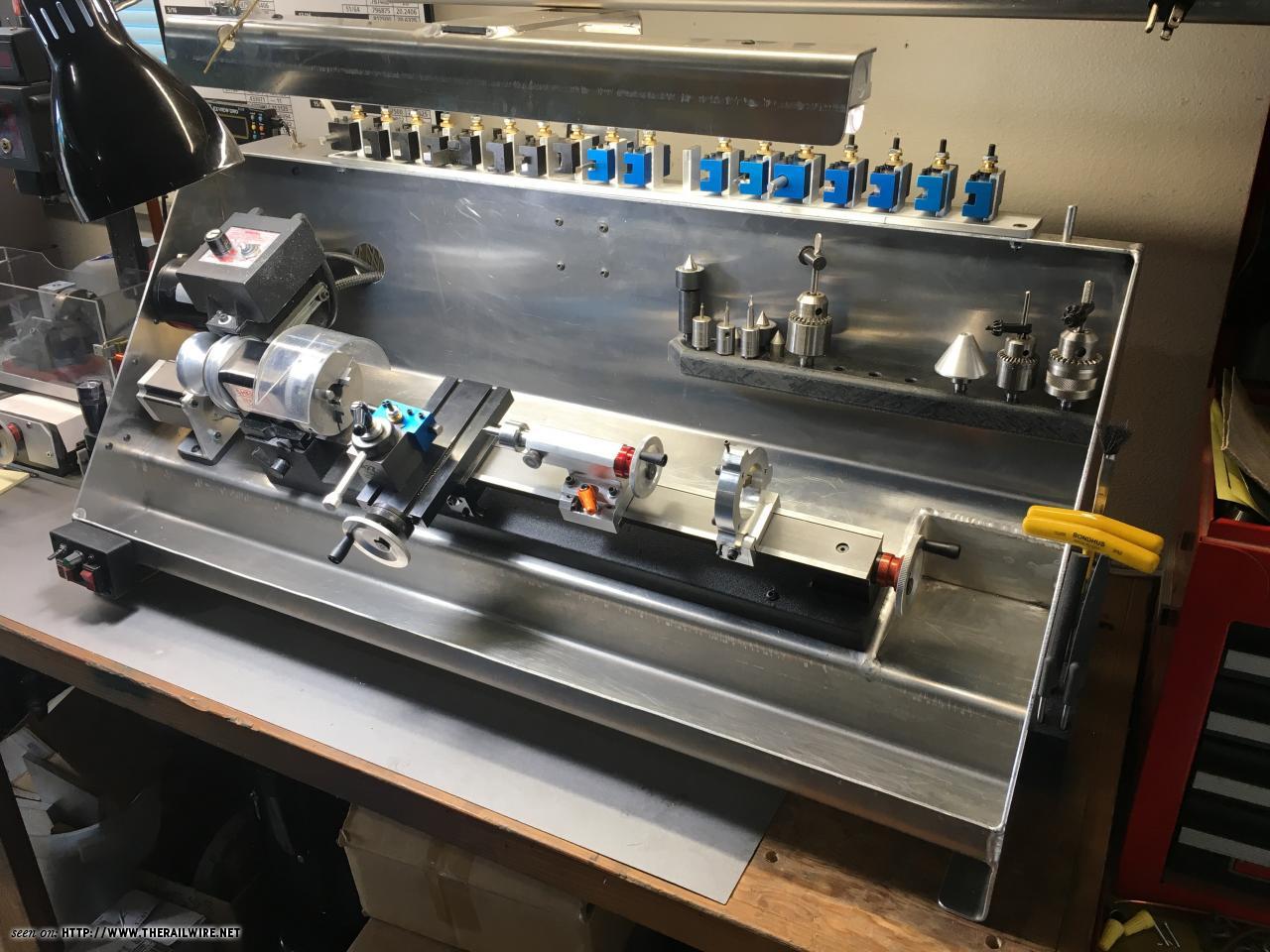

I love posts that have pictures and no commentary.

That's quite the rig, Paul. 8)  And I think I see a 4 axis mill hidden off to the left.
I'd love to see some examples of what you're making with those. 8)

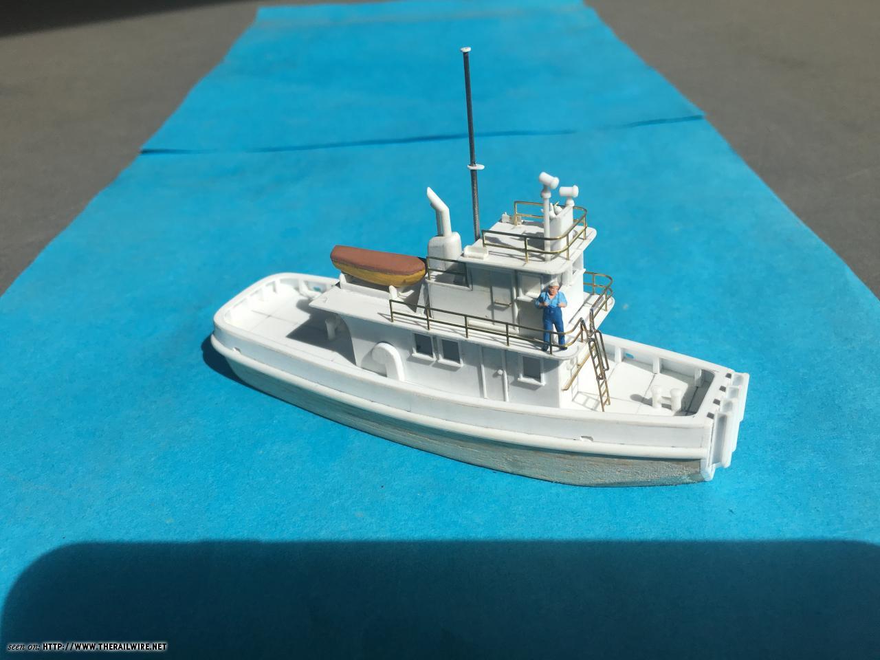

Sometimes it just a replacement motor for a poorly cast metal one to port holes and spotlights to mast parts for models. Mostly I have been making tooling for my machines which isn’t appropre to post on a model RR forum. If your a Facebook member I think the Sherline Mill and Lathe group is a public group and you can see a lot of the stuff I have been building. I just came across a Sherline CNC mill and lathe and have all kinds of crazy model  ideas to try.
But every picture .............. Like he has , or makes time to clean it up after last use . Maybe too clean .
It shows that not just in cleaning he is a neat freak , evidenced by the chuck rack upper right , and the keys in the chucks that fit and or he likes to use with each chuck .
I wonder if he welded that lathe cozy up himself as I see no wire protector in the back wall hole on the upper left .
Quite the nice setup that anybody would be proud to own . I could only dream to have .
The tailstock also looks custom made (or at least modified).
