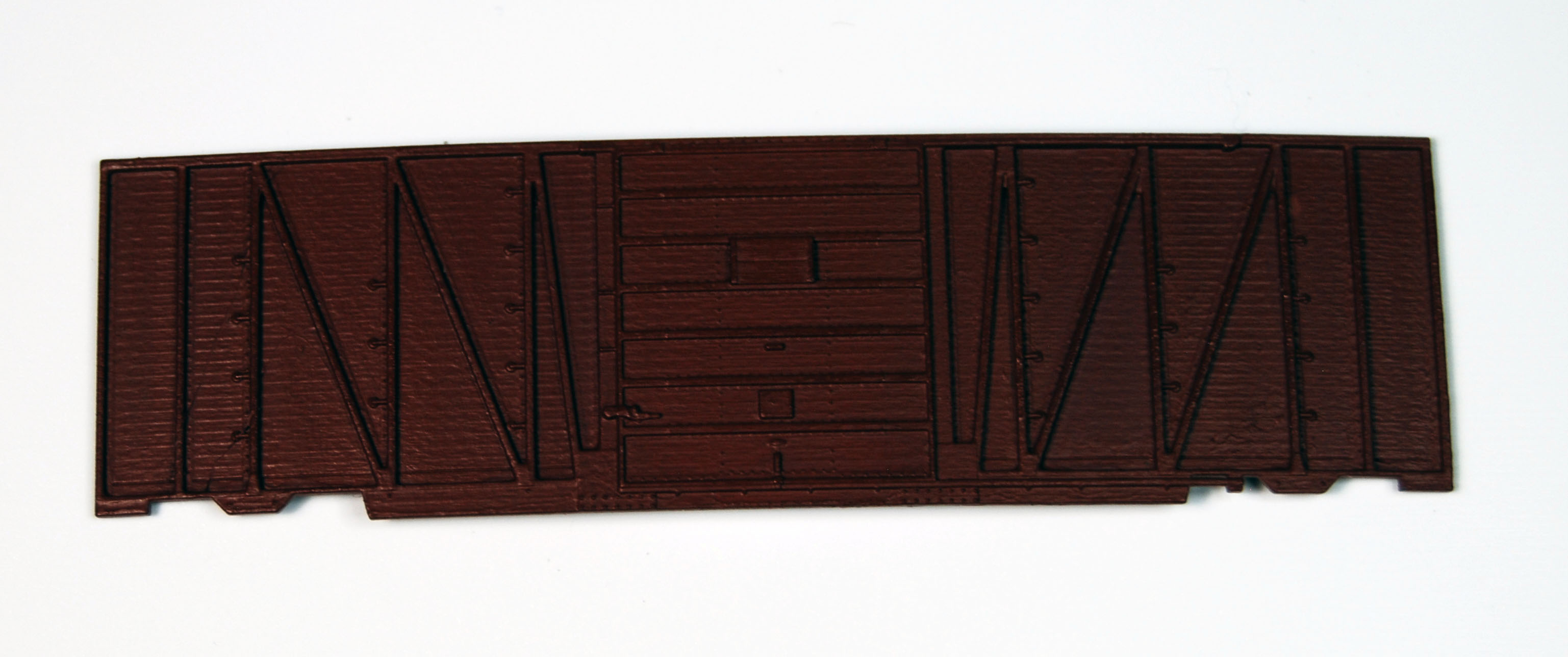

I had this idea back when constructing the FGE 5145/5237 and recently it popped up again while working on the RDG/CR BR55 RBL.
The kit could come with a floor but no under frame. Height extensions could snap on the top to bring it to plate C and F heights.
The modeler could select many parts made in plastic, resin, etched brass or prototyped from Shapeways.
Options would include:
Under frame (standard, cushioned, specific type, coupler pocket style).
Car aside detail.
Car end detail.
Car roof detail.
Car door detail.
This would allow the modeler to quickly build high quality models of less popular prototypes. Offering car "flats" would eliminate 90% of the issues we run into with FXD.
Ideas?

I'll "second" that notion.  Especially printing the parts as flats.

The problem with that is that each under frame is a different size. Your cushioned under frame is slightly longer than, say an MDC under frame. Or the width between a FVM under frame and the Atlas FGE is different.
While these could be cut up and adjusted, this adds inconsistency that a core kit would remove. The great thing about American Limited core kits was that you had a straight and true core to build off of. I am finding that this would be a benefit with kit bashing box cars as well.
A basic box that you can glue sides, ends and a roof on would be much, MUCH easier than chopping parts up, trying to get them true. Gluing long thin sides together and trying to make all the parts into a perfect box.
Actually, your under frame was the basis of the idea. I was looking at all the bodies you have planned to utilize this and thought to myself, "if someone made a basic box to plop on top of this, one could have dozens of different box car kits that wouldn't be available otherwise".
This is essentially what I had to do with the  FGE cars:
If I had to do this project over again, I would have made the core and under frame as one casting and the roof, sides and ends as a separate casting. This would have eliminated some issues with the mold that I had. But resin ien't perfect and not "true" enough. Which is why I think a plastic core kit would be a good idea.

I would have thought modifying 3D drawings would be today's method to get unique/one-off cars. This seems a backward step to when kits were 5-6 'flats' cast in resin.

The problem with 3D printing whole cars comes from the striations left on the surfaces that are not parallel to the print layers. So, printing 6 flats can make for better finished prints and more easily finished model surfaces.
Maybe some day it will be as simple as putting a 3D CAD drawing into a computer that controls a 3D printer and getting a fully assembled model.  But, not today.
Printing flat still leaves layers.  Flats and Gondolas can probably pass visually, but box cars might be a ways out.
