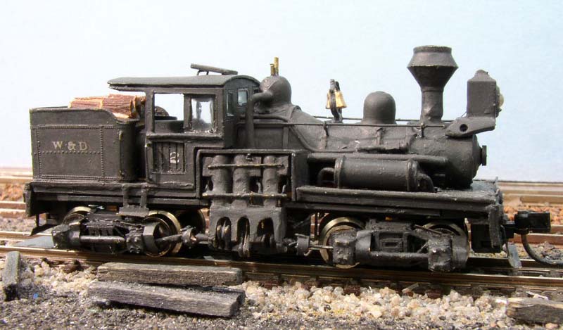

I've had reasonably good luck with using Z-scale couplers on pilots of everything, if you don't mind some surgery.
I'm amazed how well they work with regular N MT couplers, including magnetic uncoupling, if you just bend the trip pins down.  The key is if you have the space for the 903 box to fit.
Where I've had absolutely no space at all to mount anything I've wire pinned the shank of a Caboose Hobbies dummy to a pilot, after thinning the entire CH coupler about 40% because they are massively thick.
http://www.randgust.com/HVR5042%20final%205.jpg
Where I've had just a hair of space for a box I've taken the short-shank MT passenger car boxes and worked those in.  This is also where it's more important to have a functioning magnetic coupler.
http://www.randgust.com/shay2827.jpg
