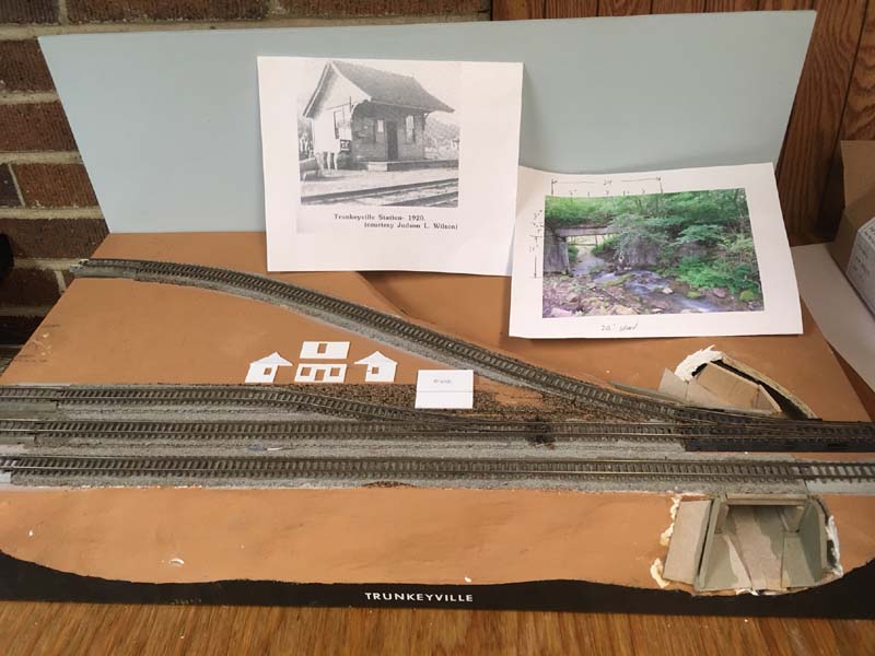

I'd already made a module good enough to run over.   I did know that one of the key features was that on the front edge - like West Hickory - the track went right off the tie edge and sloped into the river - steeply.  I knew there was a stream from the aerial, but my site visit proved I had the depth and transition all wrong.   And the culvert was a bridge.
So here's the module, and remember the reason for the siding to the back is to serve as an adapter as well as a stand-alone T-trak module.  That's not historically accurate, but then again, I haven't been able to prove exactly what was there prior to 1950.    I'm really leaning toward a weed-grown siding with gravity-fed oil tanks behind it, no monster tank, but still typical of the period.
Back at the stream, I loved what I saw firsthand, and it didn't look anything like what I thought it did.

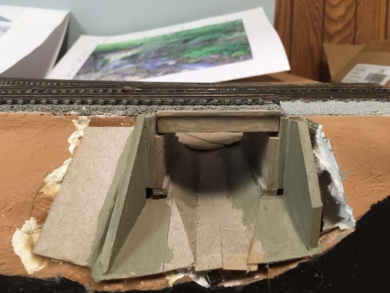

So, I ended up sawing out the entire culvert - plaster, and supporting structures, and starting over.   I confirmed the measurement to be a 20' span on the bridge, and started roughing it in with 1/8" basswood.
I've got it replaced and roughed in with the concrete bridge.   Since it would have been new then, I'm going with a more fresh and lightly weathered appearance.  More to come.
Ah, and I get to redo the plaster, and recontour the creekbed, because it rises sharply in front of that bridge, almost a waterfall.  The road had a bridge or culvert for sure to get to the station, but it's a guess what that looked like.  Maybe I'll use my stone culvert walls there.

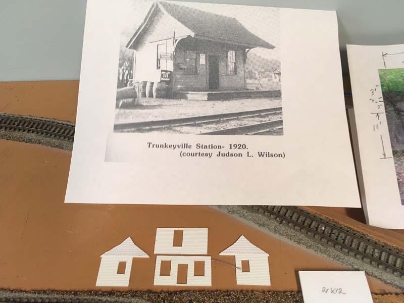

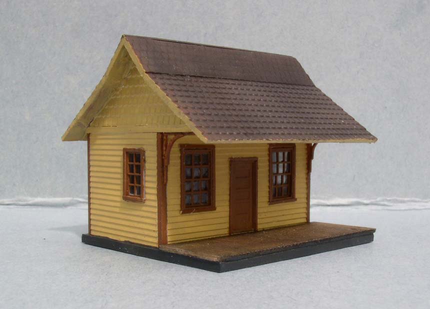

Meanwhile, I've got the station to work on, and squaring up the photos with Photoshop (de-keystoning tool) got me some dimensions.  Resized them based on the door size, and came up with 20x12 on the station itself, which seems in proportion and reasonable.   Evergreen styrene with Vollmer plastic shingle material on the gable ends.
I thought it looked like the windows were too high, until I looked at the washout photo.  There's a man standing beside the window in that shot, and the bottom of the side window is like chest level, and the walls are pretty high.  I scaled it out to 10'.    This is still such a unique structure.  The shingled sides of the gable, and the curved roof support, are complete overkill for a flagstop.    As far as I can tell, this was not a PRR standard design.  If anyone can find anything else that even resembles it, I've love to know.

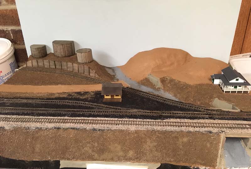

  Made a lot of progress this weekend - got the entire scenic area reprofiled, made an oil tank area up on the hill, got the road bridge abutments in the creekbed, and the road up the hill set in.  Got the dimensions figures out of what I'll call the 'post office house' and it will work where I want it.

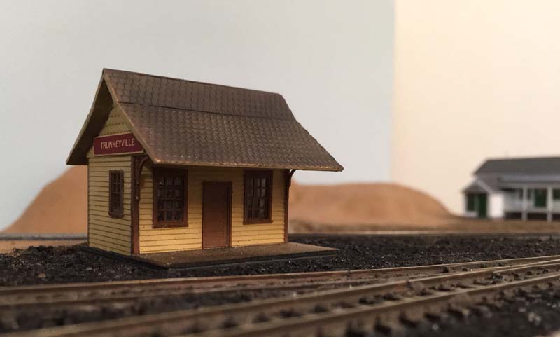

And got the station painted and assembled.

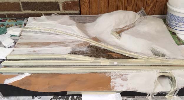

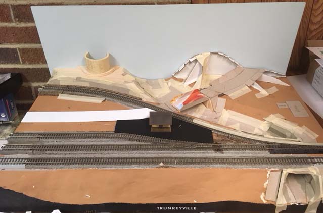

OK, so I haven't posted much to this lately, but the good news is that it's because it's moving quickly (at least for me).
Here's the update from taping, through rough scenery, and the plasterwork.
You'll notice that after looking at the hard shell outline, I cut down the one hillside a bit, looked too vertical.
On the upper left I'm making the diverting track a siding - and in salute to the oil heritage of this spot, putting in vintage crude tanks.  I came across a wonderful 1870's shot of wood oil tanks and used that for reference.   I got a couple kits and was unhappy with them, I went with PVC tubing.  More on that later.   You'll also see I roughed in the road bridge, more on that later as well.
The brown 'latex dip' soak is mostly just to preserve and seal all that fiber as the plaster and spray stages get really wet.  It's an undercoat.
I tore out the plasterwork I had done and completely redid it, the creek was too deep and the bridge was replaced with the concrete one.   One thing I observed about early oil tanks was that if they could, they always located them ABOVE the rail siding on a hill, as it was all gravity feed.  No pumps.  So given the geography I've actually seen down there (and the big flat spot above the road on the hillside that now has a newer house on it) that would appear to me to be where the original oil pipeline tanks were.
I'll get to all the details here further on, but here's the status as it sits this morning:
I'm working toward getting the creek in before Altoona anyway.   I'll post more on the scratchbuilding of the historic structures later.

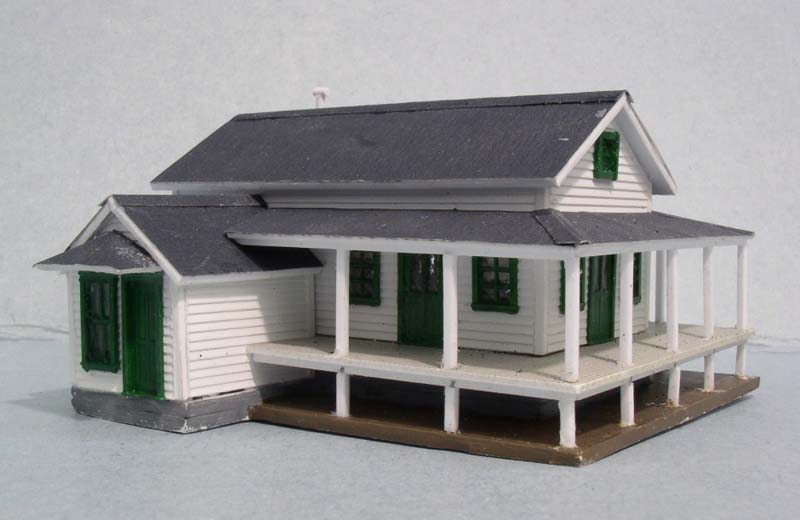

If you take a look back at the original gem of a depot photo:
http://www.west2k.com/papix/trunkeyville.jpg
And you look to the right edge, you'll see a white house with a side addition, and wrap-around porches.
When I visited there, one of the locals that was curious what I was up to pointed to a house and said 'that was originally the post office'.   I didn't think much of it at the time, but I did photobomb everything I could at the time.   When I got to really studying the pictures, I realized it WAS the same building as in the depot photo, with a second story added, but the little addition to the side now had a sliding door that was probably the PO many years ago.   But same footprint.
I'm standing on the end of the remaining railroad bridge, so the position is right.
Knowing that, I could scale the dimensions of THIS building using Google Earth, and then start studying the older photo for the one side view.
End result was a 'backdated view' of the same structure as it appears in the depot photo
I'll add more detail later, but I had to get it this far to even determine how it was going to impact the scenery and fit in the scene.
If I shoot the depot from the same angle as the historic shot, you can see what I'm trying to do here.   As close as I can get giving the limits.

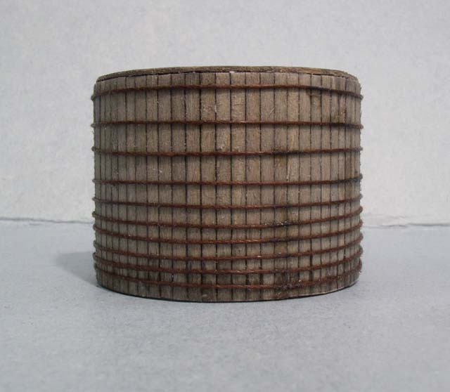

But you can see the wood oil tank construction.   So nothing out there looks like that in an existing N kit that size.  I took PVC pipe and put individual stained HO 2x6's on the surface, and then did the bands with brown carpet thread.  End result looks good.   As this is about 1920 on my module, these tanks are either on their last legs or abandoned and I very much suspect they were gone by that time, but it makes a better model anyway.  This tank transfer is why the village even existed.
